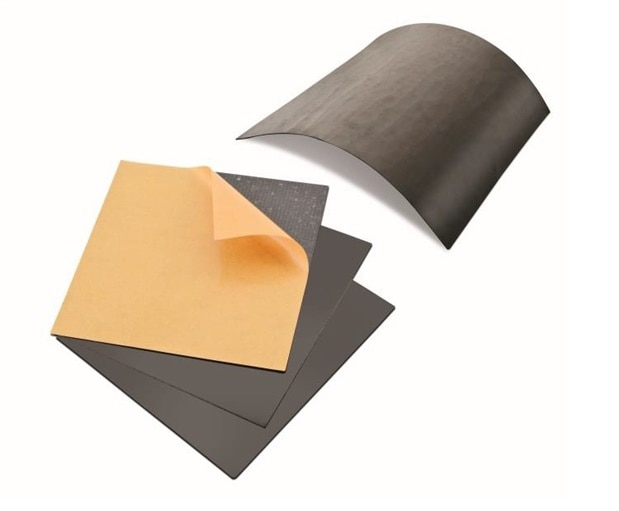

1. About WE-FSFS
Würth Elektronik eiSos Flexible Sintered Ferrite Sheet (WE-FSFS) is a product designed for high performance magnetic flux redirection. The correct management of the magnetic flux improves the energy and data transfer in inductive coupled systems (NFC, RFID, Wireless Power, etc.), achieving a higher efficiency and communication range.
Size and weight are critical parameters in today’s electronic devices, and with the last generation ferrite compositions used in WE-FSFS optimal results are achieved with minimal thickness.
The WE-FSFS is composed by three layers:
  • PET protective layer: High surface resistivity and adhesive strength to protect the ferrite layer.
  • Pre-cut Sintered Ferrite Layer: It is the core of the product. Its magnetic properties concentrate and control the external magnetic fields.
  • Adhesive layer: High adhesive strength to protect the ferrite and to apply the product.
Figure 1: WE-FSFS Sheet
imageFigure 2: Construction of WE-FSFS sheet

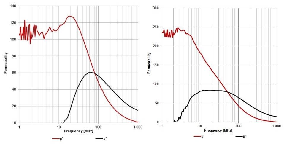

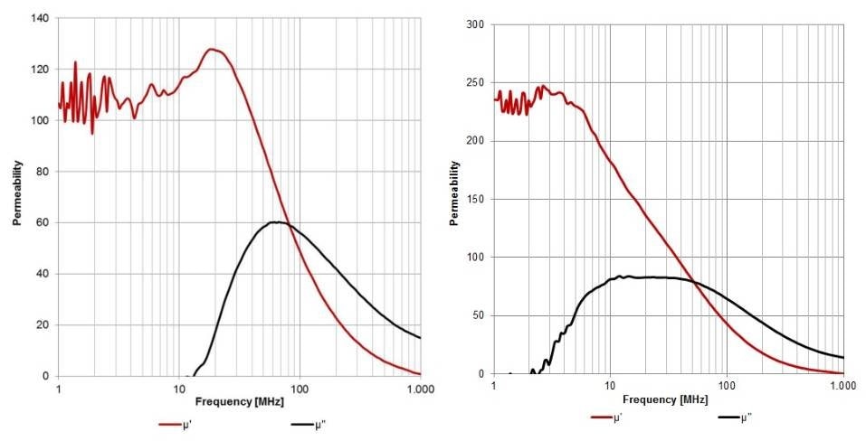

2. Permeability
The electromagnetic properties of the WE-FSFS materials are described by their relative 1 permability curves:
Figure 3: Relative permeability of 364 and 354 material
μ' is the ideal permeability, and it is the ability of the material to concentrate and redirect the magnetic flux. With a high μ’ a WE-FSFS sheet can concentrate more magnetic flux to improve the efficiency of data or energy transfer.
μ” represent the losses in the material. These losses are due to the conversion of part of the magnetic flux into heat. With a high μ", the sheet can absorb noise and convert it into heat.
Both μ’ and μ" are frequency dependent, that is why the material needs to be chosen carefully for each application. For example, for RFID 13,56 MHz applications, WE-FSFS 364 material will provide good redirection at the working frequency, and absorption for frequencies higher than 13,56 MHz (noise).

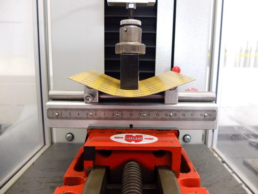

3. Flexibility
Thanks to its structure WE-FSFS, despite its thickness, is resistant enough to support manipulation during transport, storage and assembly. The ferrite layer is cut by laser in 2 mm x 2 mm size squares, protected on one side by the PET layer and on the other by the double-sided adhesive layer. This structure provides enough flexibility to stand repeated bending without a decrease on the electromagnetic performance of the product.
WE eiSos test description
Bending tests have been performed by Würth Elektronik eiSos in order to guarantee the electromagnetic properties of WE-FSFS.
Figure 4: WE-FSFS bending test
A 10 cm bending radius deformation is applied and maintained during 30 sec. The cycle is repeated 20 times. After the test the electromagnetic properties of the specimens are measured and proved to be inside the specifications.

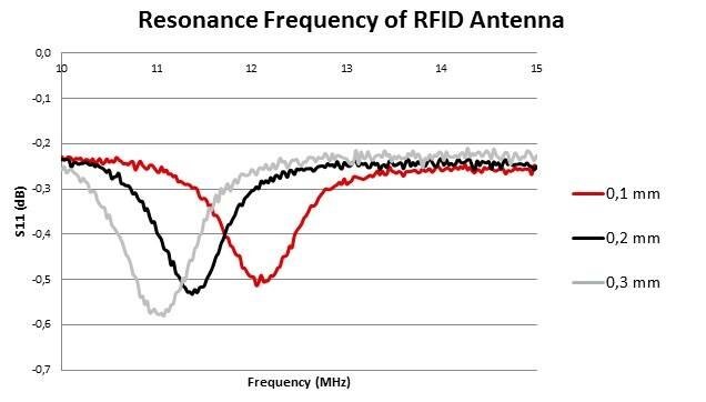

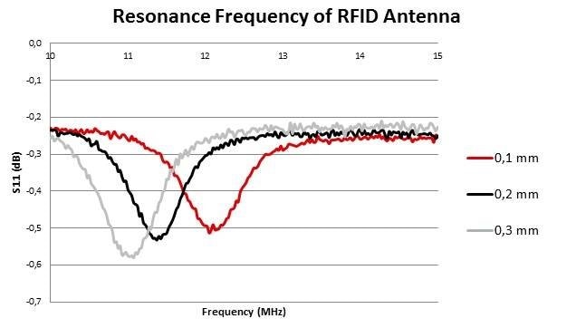

When a metal plate is placed close to a RFID antenna, this cannot work. The flux generated by the antenna crosses the metal generating eddy currents due to its conductivity. The inductance of the antenna will then decrease and the resonance frequency will shift to higher frequencies. If it is not around 13,56 MHz the communication is not possible anymore.
With a ferrite sheet attached between the antenna and the metal we can eliminate this effect, increase the inductance and shift to lower frequencies. The higher the thickness we use, the higher the shift. Correct thickness must be chosen in each application to reach the better tuning.
We placed WE-FSFS 364 ferrite sheets of different thickness between an RFID antenna and an aluminium plate 2 mm thick, and measured the frequency shift:
Figure 6: Resonance frequency shift with different thicknesses

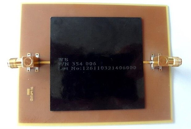

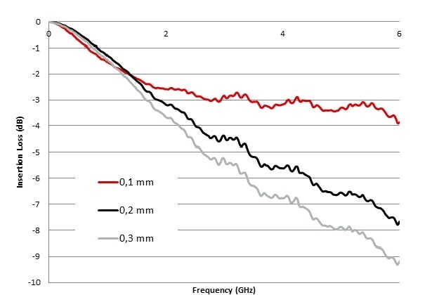

4.3. Noise Absorption:
Due to its μ" at a wide frequency range, WE-FSFS products can be used as noise absorbers. When we increase the thickness we increase the capacity of the sheet to store and convert energy into heat.
We prove it placing 60 x 60 mm samples of different thickness of WE-FSFS 354 over a Micro Strip Line and measure the absorption loss:
Figure 7: Test Setup with a Micro Strip Lineimage
Figure 8: Insertion Loss (S21) over a Micro Strip Lineimage

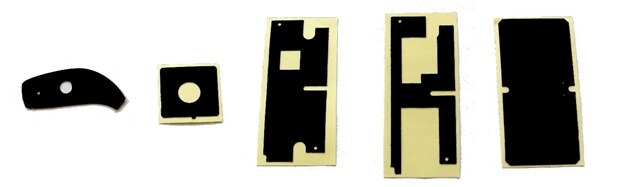

5. Dimensions
WE-FSFS can be optimized in order to fit different applications. Special designs can be supplied after request. It is important to remember the structure of the ferrite sheet (square cut 2 mm x 2 mm) and avoid when possible sharp angles and thin bridges.
Figure 9: Examples of WE-FSFS custom cuts
Note: Ii is not possible to produce a WE-FSFS sheet bigger than 120 mm x 120 mm. When bigger dimensions are needed it is possible to combine various sheets without a significant performance reduction.
