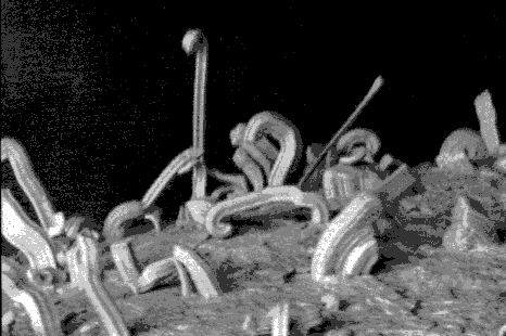

Whisker formation on tin-surfaces is a well known phenomenon since the early 50-ies. Although it was not well understood because when whiskers occurred the parameters as well as the test instruments were not well documented or still insufficient, this problem seemed to be solved by the use of lead additions to tin-surfaces. With new legislative actions in the European Community to avoid lead in electronic parts effective in 7/2006 (directive 2002/95/EC) the whisker problem came back. Suppliers of electronic materials (e.g. wires, lead frames) as well as the manufacturers of electronic parts had to face this challenge.
Figure 1: Whisker formation on Tin surface (reprinted with permission of NASA Electronic Parts & Packaging (NEPP) Program
2.1. Definition: What is a whisker?
It is a crystalline structure of material (hair like) with diameters of 1-10 μm (typically 1 μm) and a length of 10 μm to some mm.
Whiskers can be straight, kinked or even curved. Whiskers appear on tin surfaces and may reduce the Isolation resistance and/or the distance to adjacent parts. Additional problems arise when the whiskers break and short the printed circuit board or some fine pitch components. One of the most critical failures is a metal vapor arc at high currents and voltage.
Whisker induced failures are reported in commercial satellites, medical devices, power plants and consumer products.
Whiskers grow at different environmental conditions (temperature / moisture / pressure). They grow from the base, not from the top that means they grow out of the substrate.

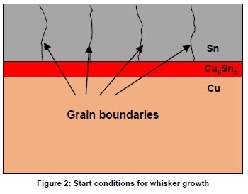

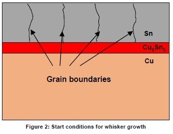

At the interface between copper and tin even at room temperature an intermetallic layer of Cu6Sn5 will form, which is shown in figure 2.
At temperatures below 60 °C the bulk diffusion of this CuSn phase is much lower than the intergranular diffusion. So the intermetallic phase more and more fills the grain boundaries which leads to an increasing stress in the Sn grains.

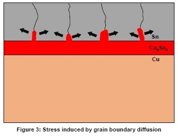

The Cu6Sn5 phase needs more space than the original material and is expanding the lattice spacing (see figure 3. The change in lattice spacing is inducing compressive stress to the tin plating.
The stress is finally released when whiskers grow (starting at small defects) and a mass transport is initiated out of the tin layer.

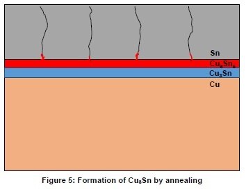

  • Make a heat treatment, within 24 h after plating, at higher temperatures >60 °C (preferred 1 h at 150 °C). A Cu3Sn layer is formed out of and below Cu6Sn5 (see figure 5). The Cu3Sn has lower molecular volume and will not add to stress in the tin layer. As the bulk diffusion is predominant in higher temperatures, a regular double layer is formed. The tendency to move into the grain boundaries is lower, as with the thickness of the barrier layers copper movement is reduced.

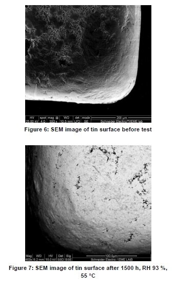

Würth Elektronik eiSos consequently follows the theories and recommendations above to reduce the risk of whisker formation. In addition to that, WE eiSos also does whisker tests to prove the quality for selected platings. As an example, the following pictures show an electroplated tin surface of a SMD lead with 2 μm (average) nickel underplating before and after a whisker growth test which was carried out by an external accredited lab.
As can be seen in Figure 6 and Figure 7, there was no whisker growth detected. These tests are carried out, to verify the effectiveness of the whisker mitigation strategies of Würth Elektronik eiSos.
