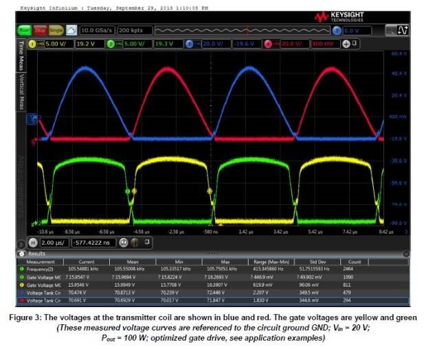

2. ZVS Oscillator (Differential Mode Resonant Converter)
A classical resonant converter is used as the clocking circuit in this Application Note.
This oscillator offers multiple benefits
  • It oscillates independently and only requires a DC source
  • The current and voltage profile is almost sinusoidal
  • No active components and no software are needed
  • It is scalable from 1 W – 200 W
  • The MOSFETs switch close to the zero crossover point

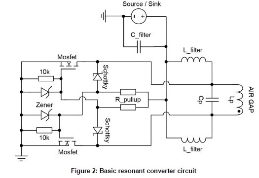

2.1. Basic Circuit / Schematic:
The basic circuit shown here is the transmitter side incl. transmitter coil LP. The receiver side can be constructed with the same Basic circuit (see chapter 3.1).
2.2. Functionality
The resonant converter usually operates at a constant working frequency, which is determined by the resonant frequency of the LC parallel resonant circuit. As soon as a DC voltage is applied to the circuit, it starts to oscillate based on the MOSFETs component tolerances. Within a fraction of a second, one of the two MOSFETs is slightly more conductive than the other. The positive feedback of the two MOSFET gates and the opposite drain of the less conductive MOSFET gives rise to a 180° phase shift. The two MOSFETs are therefore always driven out of phase and can never conduct simultaneously. The MOSFETs alternately connect both ends of the parallel resonant circuit to ground allowing the resonant circuit to be periodically recharged with energy.
Another feature of this circuit topology is that the voltage always switches close to the zero crossover point, meaning the switching losses in the MOSFETs are very low. The disadvantage of this switching topology is that the power consumption in the idle state is relatively high due to the reactive currents circulating in the resonant circuit. For this reason, the resonant converter should ideally only be operated with a load. It should be considered that the frequency of the resonant circuit changes with the coupling factor of the receiver side. This arises due to the reflected impedance from the receiver side, which influences the magnetizing inductance of the transmitter side, as both sides are in parallel. A decreasing coupling factor causes the frequency to rise, as the magnetizing inductance of the transmitter side Drops.

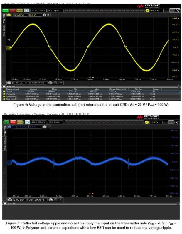

The basic circuit from Figure 1 can run with voltages from 3.3 V up to and above 230 V, depending on the components used. Above input voltages of 20 V, attention must be paid to touch protection, as the voltage in the resonant circuitis already above the SELV (Safety Extra Low Voltage) threshold of 50 VAC / 120 VDC by a factor of π or more.

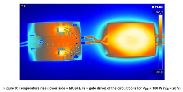

The efficiency of the entire wireless power transfer circuit may exceed 90% in practice. This is quite remarkable as the coupling losses via the air gap are already included and a steady DC voltage is available at the input. The efficiency remains stable within an air gap range of 4-10 mm. A large share of the energy in the magnetic field, which is not coupled to the receiver side, is returned to the “tank circuit”. A maximum distance of up to 18 mm is possible depending on the application however, concessions are made in terms of coupling factor and EMC.

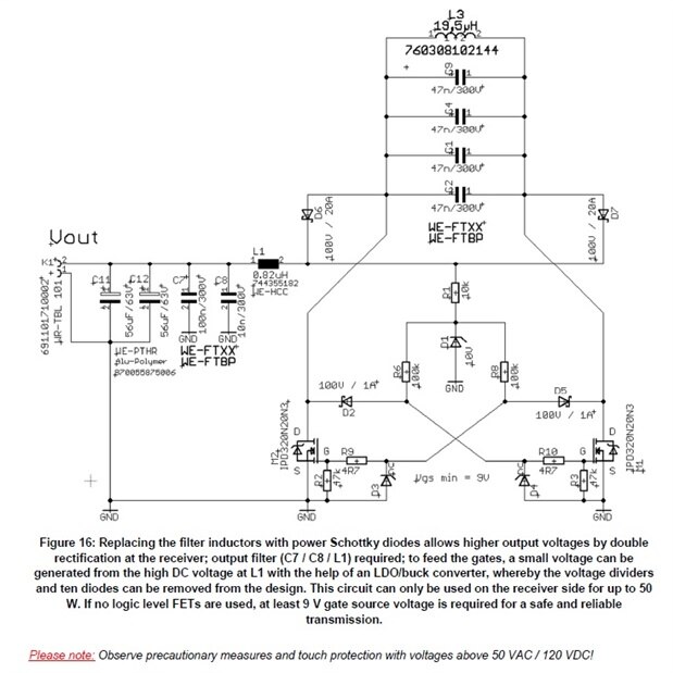

Likewise, on the receiver side, instead of a resonant converter, a classical bridge rectifier can also be used. The advantage is a higher output voltage, lower costs and space savings at the cost of efficiency, due to diode losses. The frequency under load should generally not exceed 150 kHz, otherwise the losses in the Parallel capacitors, transmitter and receivers coils become too high. Additionally, the EMC limit values are higher beneath150 kHz (e.g. CISPR15 EN55015 9 kHz - 30 MHz). The frequency range 105 – 140 kHz emerged as the best compromise in tests carried out so far. This range also ensures that you remain in a safe range according to the currently approved frequency band for inductive power transfer (100 – 205 kHz).

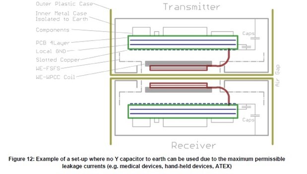

2.2.1. EMC Properties of Wireless Power Transformers
As power is transferred with all wireless power applications, compliance with the EMC limits are non-trivial. The challenge is that the transmitter and receiver coils behave like a transformer with a poor coupling factor and very large air gap. This leads to a very high stray electromagnetic field in the vicinity of the coils. EMC measurements have shown that broadband interference can occur in the spectrum of the fundamental wave through to the frequency range of 80 MHz. If the level of interference measured is kept below the limit with a reserve, it may be assumed that the limits of the interference field strength are also maintained. Generally speaking, the limit from, e.g. EN55022 Class B, may represent a development challenge which is not to be underestimated.
As the E field (stray field) is the main cause of EMC problems in WPT applications, the appropriate measures
have to be adopted:

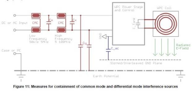

A. In order to reduce eddy currents, there should be slotted metal plane (e.g. PCB with copper) under the WPT coil (especially transmitter) and oriented towards the circuit. The circuit has to be      connected via a capacitor (e.g. 1-100 nF / 2000 V WE-CSMH) to the circuit ground or case. This short-circuits a large proportion of the E field to the source and it no longer propagates via earth.
B. Shield the transmitter and receiver coils and their drives with sufficient metal shielding and/or absorber material (WE-FAS/WE-FSFS).
C. If the leakage currents allow, Y capacitors (2x4.7 nF max.) can reduce the interference levels over a broad spectrum (WE-CSSA).
D. In order to filter common mode interference sources in the low frequency range (50 kHz – 5 MHz), depending on the operating voltage and current, the current-compensated (common mode) chokes      from the following series can be used: WE-CMB / WE-CMBNC / WE-UCF / WE-SL / WE-FC
E. In order to filter common mode interference sources in the higher frequency range (5 MHz – 100 MHz), depending on the operating voltage and current, the current-compensated chokes from the      following series can be used: WE-CMB NiZn / WE-CMBNC / WE-SL5HC / WE-SCC
F. Suppressing differential mode interference and depending on the operating voltage, capacitors from the following series can also be connected between +/- L/N: WE-FTXX / WE-CSGP
G. As very high AC currents flow in the entire circuit, depending on the application, a compact and low inductance PCB layout is essential for success in EMC. The components of the power stage and      the resonant circuit should be placed very close to each other and connected with low inductance using large copper areas (polygons).
Generally it is recommended to work with a competent EMC lab during development to measure Performance throughout the design process. Changes in mass production are always associated with higher expenses and additional workload (limits for electromagnetic field strength).

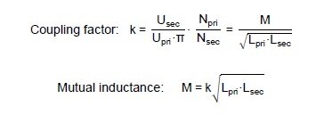

In order to avoid unwanted saturation or over-temperature of the coils, a safety buffer of 30% should always be planned for. If several coils can be incorporated, those with the highest inductance should be used, as the resonant circuit capacitor can then be smaller. Additionally, this measure reduces the reactive currents occurring in the “tank”. Smaller currents in the resonant circuit lead to lower self-heating and to better EMC properties.
The best coupling is achieved when the transmitter and receiver coils have the same package size hence, a size ratio of 1:1 is recommended. The components from the WE-WPCC Family (e.g. 760308102142 (53mmx53mm), 760308100143 (ø 50mm), 760 308 100 110 (ø 50mm)) were specially developed for high power. These coils can be used as transmitters and receivers. They are characterized by very low Rdc values very high Q values and very high Saturation currents IR.

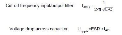

2.2.7. Input and Output Capacitor
These capacitors, in combination with the power inductors, serve mainly as filters. As the resonant frequencies are below 200 kHz, the capacitors have to be correspondingly higher. Tests have shown that values between 10 and 1000 μF are to be anticipated, depending on the application and power inductors used. The -6 dB cutoff frequency resulting from the LC filter should be around 1/10 of the resonant circuit frequency. In theory, attenuation of 40 dB / dec is expected. Taking parasitic component effects into consideration, 30 dB / dec should be expected in practice. Depending on the filter coil used, a significantly high AC current component can be superimposed on the DC current. If this current is too high, an aluminum polymer capacitor can be used in place of an aluminum electrolytic capacitor to withstand large AC currents. Polymer and ceramic capacitors, with their low ESR, also offer the possibility of significantly reducing the amplitude of the reflected voltage ripple. A smaller voltage ripple means that there is a lower interference level in the EMC interference measurement. The best result is obtained by using a parallel connection of aluminum electrolyte capacitors and polymer or ceramic capacitors (e.g WCAP-PTHR/WCAP-PSLC).

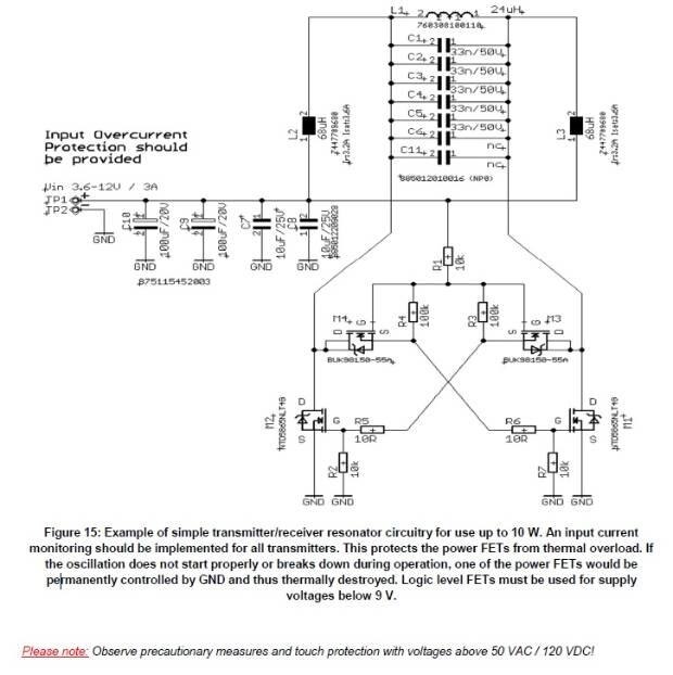

2.3. Pitfalls with the Resonant Converter
Two things in particular have to be considered in practice with this circuit topology to prevent latch-up of the MOSFETs.
1. The power supply of the transmitter at the moment of switching
If the power supply is not in a position to deliver sufficient current during transient oscillation of the circuit, it may occur that one of the two MOSFETs gets stuck in linear amplification mode and the input voltage permanently shorted to ground. This would cause the MOSFET to overheat and suffer permanent damage. Attention should also be paid that the input filter capacitor is not over-dimensioned, which could possibly further exacerbate this “latch up” effect, as the power supply has more capacitance to charge. This effect can be avoided in practice by connecting the capacitors and the resonant circuit to the operating voltage before the rest of the circuit. The gates of the MOSFETs can then be switched via optocouplers or transistors. The gates can also be driven via a separate voltage source (e.g. Würth Elektronik MagI³C Power Module) whose switchin is delayed from the supply.
2. The impedance reflected from the receiver side to the transmitter side
Given large load jumps on the receiver side or sudden changes in the coupling factors of the two coils, it may
occur that the reflected impedance partially short-circuits the magnetizing inductance of the transmitter side.
This, in turn, can lead to the oscillation breaking down and the circuit going into a “latch-up” state.
To counteract this, it is helpful to slightly detune the frequency of the receiver resonant circuit with the aid of another parallel capacitor (10 - 20% higher frequency than the transmitter). Alternatively, an additional inductance (power inductor) can be connected in parallel to the transmitter coil, which has no magnetic coupling with the transmission path. This parallel inductance has to be equal to or less than the magnetization inductance of the transmitter coil. This parallel inductance stores energy during the ZVS process and helps to maintain the oscillation in the event of unfavorable load transients.
In the first prototype phase it is important to test out all conceivable load situations, as far as this is possible, to ensure a robust design with proper functionality.

If the WPT coils are secured on metal, there may be inductive losses due to induced eddy currents caused by the magnetic stray field. In addition, the metal close by (e.g. copper on PCBs) may heat up inadvertently. Electronic circuits can also be inadvertently influenced by the strong magnetic stray fields. This effect will be higher with increased separation of the WPT coils.
Suitable measures include increasing the separation of the coils to the PCB/metal, as well as the use of highly permeable ferrite foil, such as WE-FSFS. Thus, the magnetic flux is specifically directed and is not converted into heat. This also allows the coupling factor, and therefore the efficiency, to be raised. These self-adhesive and flexible ferrite foils are available in several sizes and thicknesses.

3.1. Simple Receiver Circuit
TVS Power Diode to protect against transient over-voltages (bidirectional; max. operating voltage 60 V).
Please Note: Observe precautionary measures and touch protection with voltages above 50 VAC / 120 VDC!
3.2. Standard Resonant Converter (Transmitter and Receiver up to approx. 10 W)
3.3. Example of a Modified Receiver Circuit (up to approx. 50 W)

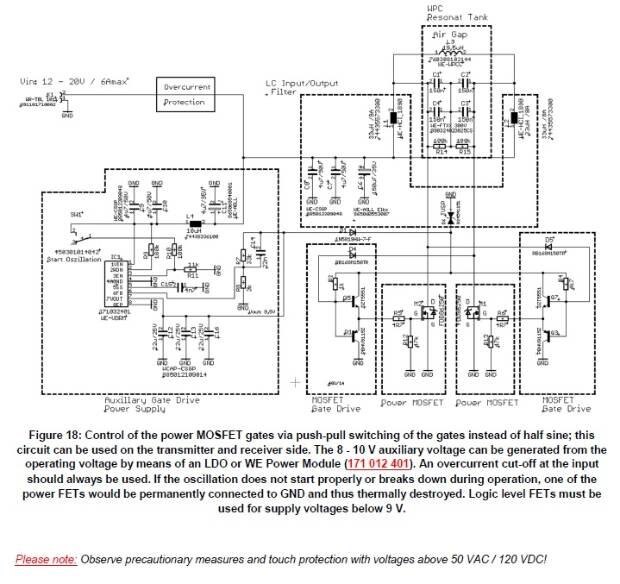

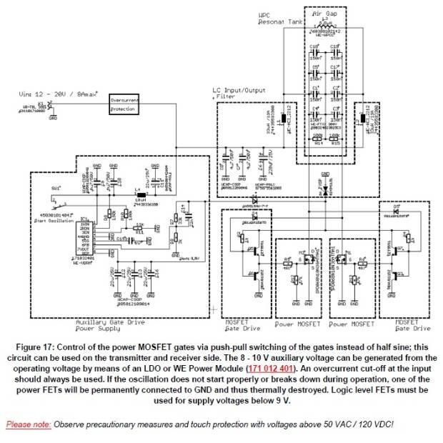

3.4. Example of Push-Pull Gate Control (Transmitter and Receiver up to approx. 100 W)
3.5. Example of Push-Pull Gate Control (Transmitter and Receiver up to approx. 60 W)
3.6. Example of Push-Pull Gate Control (Transmitter and Receiver up to approx. 30 W)

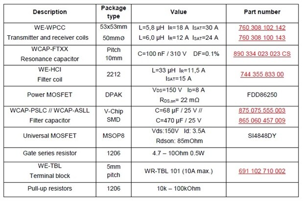

5. BOM for application example of Digikey
