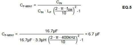

4.2.2. Selecting LF and CF
Either the inductance or the capacitance of the input filter must be chosen arbitrarily. In general there are fewer values available for inductance as compared to capacitance, so an inductor will be selected first. Values of inductance between 1 μH and 10 μH provide a good compromise between size, cost, and the resulting resonant frequency of the input L-C filter. The rated current, IR, of the inductor (also referred to as the RMS current rating) must be greater than the maximum input current, IIN-MAX, to keep the inductor´s temperature within its recommended operating range.
For this example where maximum input current is 2.6 A the Würth Elektronik eiSos WE-SPC 4838 series 744 089 430 33 is a 3.3 μH device in a small footprint (4.8 x 4.8 x 3.8 mm) with a DCR of 31 mΩ and current ratings of  IRMS =2.6 A and ISAT = 3.6 A that is well suited for this example. With inductance chosen, two equations exist for selecting the required capacitance. The first is based upon the resonant frequency of the filter, which should be kept to 1/10th of the switching frequency or less:
The result of EQ.5 may be negative – this would indicate that with the chosen inductor value it is not possible to attain a filter resonance frequency ten times lower than the switching frequency. The inductor value can be increased if desired, though this comes at a penalty of lower efficiency and/or a larger inductor due to the higher DCR and higher core losses that accompany higher inductance. Setting resonant frequency ten times below switching frequency is a guideline, not a hard limit.
The second equation is a hard limit, and it predicts the minimum capacitance needed to ensure that the voltage ripple at the input to the converter is below the limit set by the target for noise attenuation, ATT:
The capacitor chosen should be greater than the larger of the two values given by CF-MIN1 and CF-MIN2, and MLC capacitors are the best choice. To keep the BOM simple, another capacitor identical to C3 and C5 could be used (10 μF, 1210, 50V, X5R, low ESR) which will give 8 μF of capacitance at 15 VDC, more than enough to properly filter the input.
