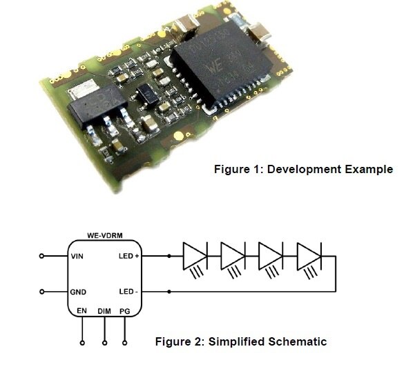

1. Introduction
The DNS14 is a reference design for the WLMDU9456008T LED driver capable of driving up to 1.5 A output current using a voltage regulated module and an external secondary regulation loop to establish current regulation. The external loop regulates a DC output current which results in a constant photon flow. Compared to other solutions with PWM, this solution is less harmful to the eyes due to the constant photon flow, allowing the pupil opening to be the proper size for the light intensity emitted. Depending on the LED flux voltage up to 4 LEDs in series can be connected.

3. Description
The power consumption of LEDs on the lighting market is constantly increasing. LEDs require currents of 700 mA, 1 A or higher. High output currents are supported commonly with voltage regulated modules. Constant high current led drivers are uncommon on the market. This design note describes how to convert a voltage regulated module to a current regulated module. Typical supplies for LEDs are modules operating as current sources. They include dual protection against output short circuits. A current regulated circuit is - if designed properly - short circuit protected by itself due to its nature of forcing a defined current into the load regardless if the load is an LED or a low resistance like a short circuit. The second overcurrent protection circuit is integrated in the module commonly through a cycle by cycle current limit.

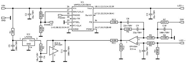

A MagI³C VDRM module is used in this application. Natively it is voltage regulated. The current through a specific number of LEDs will flow from LED+ pin through the LEDs to the LED- pin. The LED current flows through a shunt resistor, R3, and the voltage across R3 is compared with a dimming voltage. A 5 V dimming voltage at the DIM terminal results in a voltage of 75 mV at the regulation loop amplifier (IC3, pin4) with which the shunt voltage (IC3, pin 3) is compared. IC3 is used for an outer and slower regulation circuit which drives the feedback pin of the VDRM module. The compensation network consists of C8, C9 and R6, which may be trimmed by the design engineer depending on the customer PCB layout if modified from the reference design PCB layout.
An external dimming (adjusting) voltage is always required. This can be derived directly from VIN if stable or from a resistor divider from the 3.3 V of the linear regulator (IC2).
The supply of the operational amplifier is derived from VIN with a linear regulator (IC2) with a capability of abs. max. 40V or 60V input voltage. Its output voltage is set to 3.3V. The Input voltage of the design ranges from 7 V to 50 V (only with the 60 V version of the LM2936, which is not available in this small package) and the output current ranges from 0 A to 2.5 A. Note that the output power shall not exceed 22.5 W. The compensation may be adapted for various operating points.
This Reference Design is developed using the following specification:
Vin = 7 V - 24 V     Vout = 0 V - 15 V     Iout = 10 mA - 1.5 A

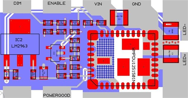

5. Schematic and Layout
Figure 3: Schematic
Figure 4: Layout
