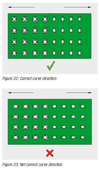

To ensure proper solderability and correct positioning of the component, the solder paste must be evenly plotted to each recommended land pattern (see Figure 12).
To prevent crocodile or tombstone effect or other effects of soldering, take care about correct positioning of the component. Avoid also vibration or any other impact of the mounted board after the components were mounted on the substrate before soldering process.
SMD components must be mounted according to recommended land pattern design and correct connection. Please confirm and verify first before designing the soldering land pattern in order to obtain the best performance for soldering.
