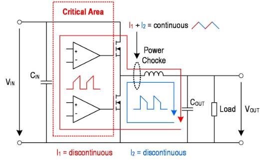

2 The Buck Converter - General Setup

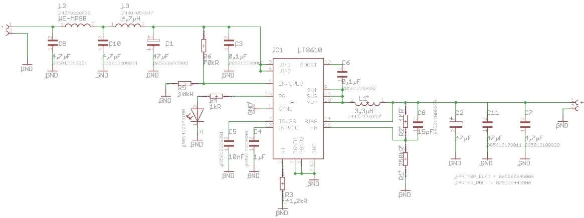

To demonstrate the positive effects of the polymer electrolytic capacitor a buck converter is used. The input voltage is 12 V and the output voltage has been set to 5 V. The load is a pure ohm load of 5 Ω. This results to a current of 1 A flowing through the resistor. This setup serves as a basis to make the performance of polymer electrolytic capacitors clear. The design is used for both EMC measurement and voltage ripple output measurements with always the same load. From the EMC point of view, a buck converter is much more critical at the input side. This is due to the discontinuous current consumption based on the fast switching processes of the semiconductors. As a result of this topology, there is already an "LC filter" at the output, which integrates the discontinuous current on the high side (refer to Figure 2).
Figure 2: Principle of a buck converter
The construction and design of the buck converter was based on the specifications of the data sheet and designed with the default values for the coil and capacitors. The inductance values of the coil and the capacitance of the input and output capacitors were verified by the manufacturer's data sheet and with their simulation software. This was especially important when using only one aluminum electrolytic capacitor. Due to the very high ESR value, the stability of the regulator was impaired. To counteract this effect, a capacitor was additionally attached to the feedback loop. This additional capacity ensures stability even at high ESR values. In Figure 3 the circuit diagram of the buck converter and in Figure 4 the associated layout is shown. The layout consists of two layers, each with full copper areas on the top and bottom sides with connection to ground. The layout itself could still be improved at various points. Above all, the connection of the components to the ground layer still needs optimization to achieve a better filtering effect. It can clearly be seen in the measurement of the output capacitor that the high parasitic inductance causes voltage peaks on the output signal.

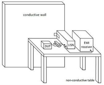

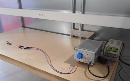

The measurements were made according to the CISPR 32 standard (which replaces CISPR 22 and 15) in an RF-shielded chamber with the corresponding connection to the ground surface of the cabin, see Figure 5. The test receiver was an R&S ESRP 3 and as network simulation an ENV216 two-wire V-net simulation was available.

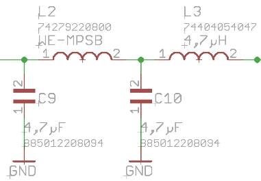

During the measurement, in the first step, further input filters on the layout were dispensed; only in the last measurement was a T-filter with a separated coil placed. This filter was constructed according to the specifications in the data sheet. For the first measurement, an aluminum electrolytic capacitor WCAP-ASLL 865 060 343 004 was used for the input capacitor C1 (Link to REDEXPERT). The electrical properties of the capacitor are as follows: Capacitance 47 μF, rated voltage 16 V with an ESR 411 mΩ and ESL 19 nH. The associated measurement result is shown in Figure 6.
Figure 3: Schematic of the buck converter

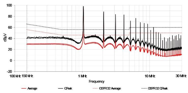

It can be seen that the limit values of CISPR 32 class B are clearly exceeded. There are noise levels of up to 100 dBμV detectable. But where do these interfering signals come from? The capacitor as a real component has parasitic effects, particularly the ESR together with the parasitic effects of the layout (the lead inductance) generate a high-frequency voltage drop that can be detected by measurement. This is shown schematically in Figure 7. As a first approach to achieve acceptable levels of emissions and stay below the limits, an aluminum polymer capacitor can be used. The electrical properties in terms of capacity and rated voltage of the aluminium polymer capacitor are the same as those of the aluminum electrolytic capacitor.
Figure 5: Setup of the EMC measurement according to CISPR 35
Figure 6: First EMC measurement with an aluminum electrolytic capacitor as C1
imageFigure 7: Schematic representation of the cause of the disturbances

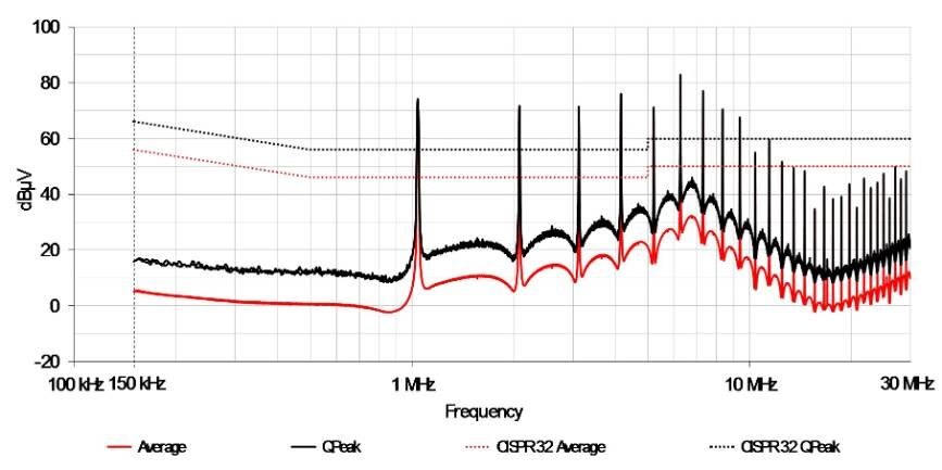

Figure 8: EMC measurement with an aluminum polymer capacitor as input capacitor C1
The design is also equivalent at the capacitance of 47 μF and the capacitor fits to the original landing pattern. The aluminum polymer capacitor used was a WCAP-PSLP 875 105 344 006 (Link to REDEXPERT) with a capacitance of 47 μF, rated voltage of 16 V and with an ESR of 20.7 mΩ and ESL of 3.9 nH. Due to the very low ESR and ESL, the following measurement of the interference spectrum is achieved, which can be seen in Figure 8.
It can clearly be seen that by changing only one component, the EMC performance was significantly improved. The voltage drop which is generated by the fundamental frequency and the first harmonic of this frequency is reduced and thus less interference is generated. However, the limit could not be met and therefore further filters have to be placed. The structure of the input filter was based on the information in the data sheet. Therefore, the filter has the following insertion loss (in a 50 Ω system), as shown in Figure 9. The input filter was then included on the PCB and another measurement performed. The result is shown in Figure 10 where the interaction between the aluminum polymer capacitor and the input filter is visible. The combination of input filter and low ESR and low ESL of the polymer electrolytic capacitance makes it possible to push the level broadband below the limit of class B. Values of less than 40 dBμV (Average & Quasi Peak) are easily possible (compared to the first measurement with around 100 dBμV) and so, the measurement is passed.
imageimageFigure 9: Built-in input filter with simulated filter performance
Figure 10: EMC measurement with input filter and aluminum polymer capacitor C1
