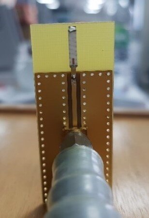

The trend to miniaturize wireless communication devices has led to decreased PCB sizes and increased component densities. Although this shift to miniaturized technology has aided many areas of electronic design, it constrains RF front-end design. Due to the nature of antennas sending and receiving electromagnetic signals, they interact and are affected by the entire surrounding environment and are extremely sensitive to electromagnetic fields. This can be extremely problematic for RF engineers when integrating into a design an antenna that is small, has good gain and efficiency in the frequency range of operation, and is able to work as desired in different PCB environments. Multilayer chip antennas are an interesting choice for engineers, who are restricted by cost and space requirements in wireless system design. Low temperature co-fired ceramic (LTCC) multilayer chip antennas are formed from several layers of dielectric material, which are pressed and fired together into a monolithic structure. Each dielectric layer has patterned metallization on the surface that connects to other layers through vias. The layers and vias form a helical multilayer antenna. This application note explains how to get the maximum performance from the Würth Elektronik WE-MCA Multilayer Chip Antenna with respect to antenna placement on a PCB and effective impedance matching.
Figure 1: The WE-MCA Multilayer Chip Antenna

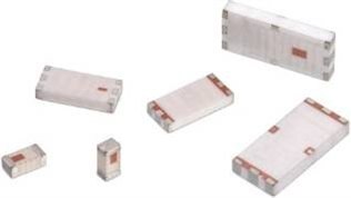

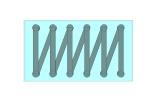

The importance of antenna placement is clearly understandable when the structure and operating principle of an antenna are considered. For this purpose, the WE-MCA Multilayer Chip Antenna (748 893 02 45) has been simulated in a 3D electromagnetic design tool (CST Microwave studio, CST, Germany) to illustrate electromagnetic fields and radiation patterns. The multilayer chip antenna consists of metallic layers, connected by vias and enclosed by ceramic material (Figure 2). The inner conductors and vias form the radiating, multilayer meander structure. Electromagnetic fields are generated by the currents on the inner conductor (Figure 3). This self-resonating meander structure allows the component to be smaller than a monopole antenna while achieving comparable performance. The antenna is designed to operate at a centre frequency of 2.45 GHz (Bluetooth/Wi-Fi) with a 10 dB bandwidth of more than 250 MHz with more than 30 dB return loss as evidenced by the simulated S-parameters (Figure 4).
Figure 2: Internal structure of the WE-MCA Multilayer Chip Antenna (748 893 02 45)

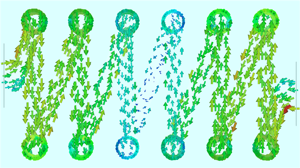

Figure 3: Simulated surface current of the WE-MCA at a frequency of 2.45 GHz

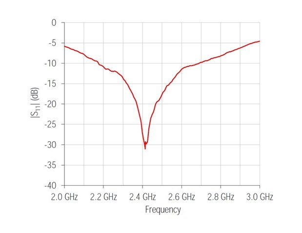

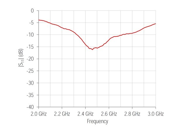

Figure 4: Simulated S11 and S21 parameters of the WE-MCA (748 893 02 45) multilayer chip antenna

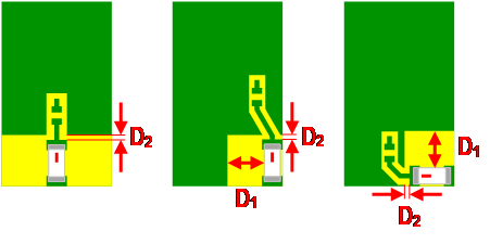

3.1. Corner placement
Placing the antenna on the PCB corner is generally the most desirable location. This typically results in better antenna gain. If the antenna is placed in a corner, it will be surrounded by a ground plane on only two sides. When the antenna is placed in the corner of a PCB, the following criteria should be implemented to achieve optimum antenna performance (Figure 5).
Figure 5: Design rules for WE-MCA Multilayer Chip Antenna corner placement. Where, D1 > 2W; D2 = 0.5 – 1 mm; and A1 = 1 – 2 mm2 (yellow Surface). W = antenna width
3.2. Side placement
The antenna may be placed on the side of the PCB where it is surrounded on three sides by ground plane when it is not possible to place the antenna on the corner, although antenna performance may be reduced. To ensure the best performance in this position, the following design criteria need to be met (Figure 6).
Figure 6: Design rules for WE-MCA Multilayer Chip Antenna side placement. Where, D1 > 4W; D2 > 2L; and D3 > 3W. L = antenna length

The impedance can be measured with the help of Vector Network Analyzers (VNAs). VNAs are able to measure the amplitude and phase angle of a system. The measurements can be displayed in a number of formats but S-parameters and the Smith Chart are the most useful tools when matching the impedance of an antenna.
4.1. S-parameters
S-parameters are part of a larger group of similar parameters (e.g. Z-parameters, Y-parameters) and use matched loads to characterize a system. For S-parameters, the system containing any number and variety of components is treated as a black box with ports. S11 provides information about the amount of power that is being reflected (return loss) back to the port while S21 is the power that is being transmitted (insertion
loss) from port 1 to port 2. Measurements are represented as a complex number that corresponds to magnitude and phase angle. This can be displayed in either Cartesian form, where magnitude and phase are presented in decibels and degrees, or polar form, where a data point represents a measurement at one frequency or a locus for a data spectrum.

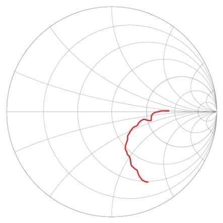

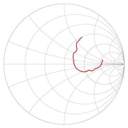

4.2. Smith Charts

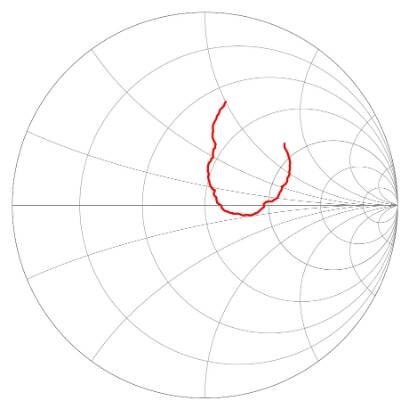

The Smith Chart is a graphical tool that plots the complex impedances in polar form and is commonly used by RF engineers to facilitate transmission line theory problems. The true power of the Smith Chart lies in its ability to display multiple parameters of interest simultaneously. Some of these parameters include impedance, admittance, S-parameters, VSWR and constant gain circles. Looking at Figure 8, the collection of circles, arcs and lines can initially seem quite intimidating. However, in reality, only a few simple things need to be understood to correctly interpret it. The red circles and red arcs that we see in Figure 8 are resistance and reactance lines respectively and are always touching the chart outline at 90°. It must be remembered that the resistance and reactance remain constant if the movement is along these circles and arcs. Similarly, the blue circles and curves that are touching the outline of the Smith Chart at 270 ° are called conductance and susceptance lines. At the center of the Smith Chart is the 50 Ω point, which is also the point of interest since the characteristic impedance (Z0) of antennas is almost always 50 Ω.
Figure 8: Example of a Smith Chart with conductance and susceptance lines (blue), and resistance and reactance lines (red). Additionally, this Smith Chart includes a VSWR circle (green)

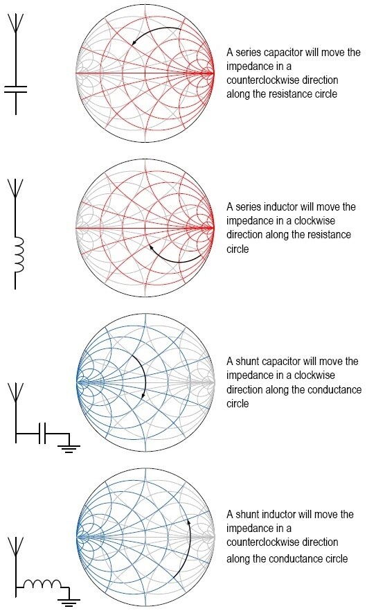

Figure 9: The effect of passive components on the impedance of the matching network
Once a measurement is made, it appears on the Smith Chart as a complex impedance with resistive and reactive components. The goal in this case is to move the impedance at the antenna operating frequency to the center of the Smith Chart (50 Ω). This can be achieved using RF inductors and/or capacitors. A pi-network is especially useful for this purpose as it can be used in a very flexible way for antenna tuning to 50 Ω from almost any other value. In typical scenarios, only two reactive components (inductor and capacitor) are needed to match the impedance to 50 Ω, but a pi network should always be implemented in PCB design to offer maximum flexibility later in the development process. Using the principles below, it can be visualized what components need to be used and in which topology to achieve the desired matching.

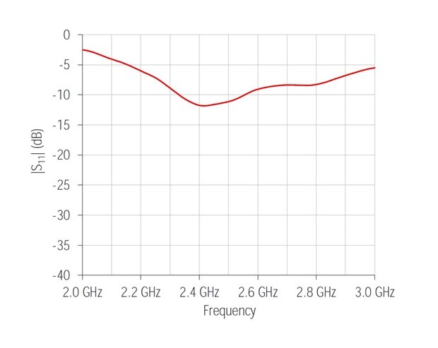

For lower frequency antennas, it is possible to use a 0 Ω resistor to short the pi network to see how the antenna is performing without a matching network. However, at higher frequencies, the parasitic inductance of a 0 Ω resistor becomes significant enough to effect the network. Therefore, a capacitor with its self-resonant frequency at the antenna frequency can be used as a short. In theory, when the capacitor is used at its SRF, the impedance should be resistive and not reactive. Although the capacitor has ohmic impedance, at these frequencies it will work as a short with no reactive element, which is better than a resistor with parasitic reactance. For our example, a 15 pF high-Q RF capacitor was used (Figure 10) and the S-parameters (Figure 11) and complex impedance measured (Figure 12).
Figure 10: Shorting of the matching network with a 15 pF capacitor
Figure 11: The S11 parameters of the shorted WE-MCAFigure 12: The complex impedance plotted on a Smith Chart of the shorted WE-MCA
This gives important information about the impedance of the antenna in-situ and indicates what capacitance and inductance needs to be added to the matching circuit to bring the markers to the center of the Smith Chart and achieve a matched impedance. Software and online tools can also be used to select the component values. From the Smith Chart (Figure 12), we can see that 4.8 nH of parallel inductance and 1.6 pF of series capacitance needs to be added to bring the voltage and current into phase for maximum antenna efficiency.

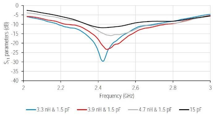

Since standard RF inductors and capacitors are available in a limited number of values, a 4.7 µH inductor, and a 1.5 pF capacitor were used and the S-parameters re-measured (Figure 13).
Figure 13: The S11 parameters of the partially matched WE-MCAFigure 14: The complex impedance plotted on a Smith Chart of the partially matched WE-MCA
We can see that although the WE-MCA is performing better than unmatched antenna, the gain and impedance matching is still suboptimal (Figure 14). This is where knowledge, practice and experience will really pay off in optimizing the matching circuit. It will normally take a number of iterative steps to achieve optimal matching. For our example, the 4.7 nH inductor was replaced with a 3.9 nH inductor and the antenna re-measured.
Figure 15: The S11 parameters of the sub-optimally matched WE-MCAFigure 16: The complex impedance plotted on a Smith Chart of the sub-optimally matched WE-MCA

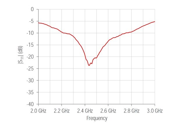

The result with a 3.9 nH inductor and a 1.5 pF capacitor, shows that although the impedance is almost matched, the return loss is not below 25 dB (Figure 15). This will be more than sufficient for the majority applications where a wide bandwidth is needed, but this can be improved further. In the final step, the inductance of the matching network was lowered by exchanging the 3.9 nH inductor with 3.3 nH inductor.

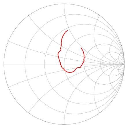

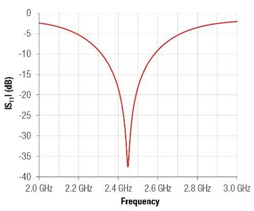

Figure 17: The S11 parameters of the optimally matched WE-MCAFigure 18: The complex impedance plotted on a Smith Chart of the optimally matched WE-MCA

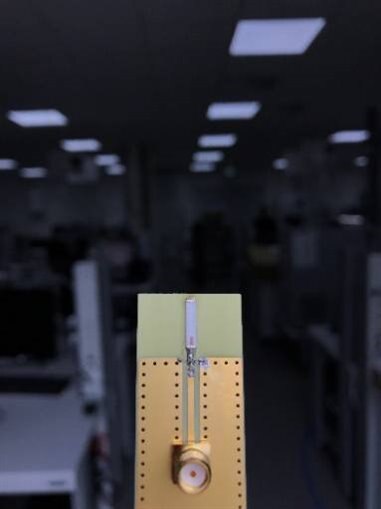

We can see that with a 3.3 nH inductor, and a 1.5 pF capacitor, optimal impedance matching is achieved with the data point of the resonant frequency very close to the center of the Smith Chart (Figure 18), a return loss of around 30 dB while maintaining a 10 dB bandwidth of 500 MHz (Figure 17).
Figure 19: Population of the matching network with a 3.3 nH inductor, and a 1.5 pF capacitor
From this example, we can see the importance of bringing together theory and an iterative process to accomplish optimal antenna performance (Figure 20). It is appreciable that the matching process may need to be repeated at numerous stages of the design process for system verification.
Figure 20: The effect of decreasing parallel inductance in the matching network of a WE-MCA Multilayer Chip Antenna
