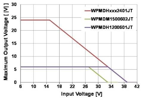

3. Voltage, Current and Duty Cycle Limitations
Selecting the proper MagI³C Power module for buck topologies is straightforward – the input voltage range, output voltage range and output current range listed in each module´s datasheet show the precise limits for each of these quantities. For the inverting buck-boost more calculations are required, and both the maximum input voltage range and the output current range are lower when using this topology than they are for the buck.
3.1. Input Voltage Range
Closer inspection of the buck-boost regulator in Figure 3 reveals that the module´s reference voltage is no longer system ground, but in fact is the negative output voltage. The total voltage from the VIN pin to the AGND pin of the module is equal to the input voltage plus the absolute value of the output voltage. This can be observed by considering that the voltages across CIN2 and COUT add together, with system ground at their midpoint. Table 1 shows the maximum input voltage rating for each member of the VDRM family:
TypePackageWE Order CodeFarnell Order CodeWE Part DescriptionVIN [V]VOUT [V]IOUT [A]
Variable Step Down Regulator Module (VDRM)TO263-7EP1710124011710124012505846WPMDH1102401J6 - 425 -241
TO263-7EP1710124021710124022505847WPMDH1152401J6 - 425 -241.5
BQFN-391710203021710203022577475WPMDB1200362Q2.95 - 60.8 - 3.62
TO263-7EP1710206011710206012505848WPMDH1200601J6 - 420.8 - 62
BQFN-411710215011710215012505851WPMDU1251501N7 - 502.5 - 152.5
TO263-7EP1710324011710324012505849WPMDH1302401J6 - 425 - 243
BQFN-391710403021710403022577476WPMDB1400362Q2.95 - 60.8 - 3.64
TO263-7EP1710506011710506012505850WPMDM1500602J6 - 360.8 - 65
BQFN-391710603021710603022577477WPMDB1600362Q2.95 - 60.8 - 3.66
Table 1: Input voltage, output voltage and output current ranges for the VDRM MagI³C Power modules
So for example the 171 032 401 (42 VIN / 3 A / 5 to 24 VOUT) when operating at an input of 24 V would be limited to a theoretical maximum output voltage of -18 V. In practice at least 3 V to 4 V of headroom should be left for ringing and transients, so the recommended maximum output voltage for an input of 24 V would be around 14 V to 15 V.
Buck-boost operation also has a distinctive advantage over the buck regulator: as the name implies, the absolute value of the output voltage can be higher or lower than the input voltage. As long as the minimum on-time and off-time of the modules are respected, an output of -12 V is possible from an input as low as 6 V. Furthermore, once the module is operating the input voltage can go even lower than the normal, buck mode minimum VIN of 6 V as long as the sum of (VIN + |-VOUT|) is greater than or equal to 6 V. Figure 5 shows maximum input voltage as a function of the output voltage and also maximum output voltage as a function of input voltage.
Figure 5: Graphical maximum input voltage and output voltage relationships

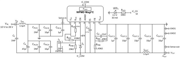

4. Design Guide
This section will guide the user through the design and external component selection of an inverting buck-boost regulator meeting the following specifications:
Input Voltage: VIN = 10 VDC to 28 VDC
Output Voltage: VOUT = -12.0 VDC, IO-MAX = 1.0 A
Estimated Power Efficiency, η = 90%
This converter can operate from 12 VDC or 24 VDC power inputs, rectified 12 VAC inputs, 12 V and 24 V batteries. The -12 V output could be used to power amplifiers, sensors or other analog functions that require a negative voltage.
Figure 6: Circuit schematic for the design example

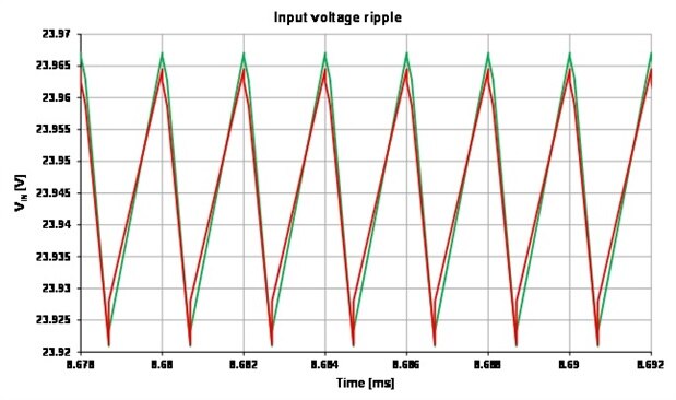

Balancing the total capacitance between positions CIN1 and CIN2 affects both the input voltage ripple (taken from VIN to system ground, where conducted EMI is measured) and the output voltage ripple. In general, the best compromise comes from putting half of the total capacitance calculated in EQ.15 at CIN1 and the other half at CIN2.
MLCCs are an excellent choice for the input capacitors for inverting buck-boost regulators due to the high- RMS currents seen by both CIN1 and CIN2. The 40 V and 28 V maximum voltages seen by CIN1 and CIN2 respectively mean that a minimum of 50 V rated capacitors should be used, with X5R or X7R dielectrics. For this example 1210, X5R, 50 V rated 10 μF devices will be used. Despite the loss of capacitance due to DC
bias, one advantage to designing with MLCCs is that the worst case where the most capacitance is needed is at the minimum input voltage where the capacitance loss is lowest. For this example at 22 V for CIN1 the actual capacitance is around 6 μF, and at 10 V for CIN2 the actual capacitance is around 9 μF. One capacitor will be placed at each position. Owing to the complex interaction and the difficulty of measuring currents through capacitors in the lab, a simulation can be very helpful. Figures 8 and 9 show the input voltage ripple with respect to ground and the output voltage ripples between two cases: all of the capacitance placed at CIN2 and then the recommended split of capacitance between the two positions.
In this example the input voltage ripple is similar between the two cases but is actually slightly higher when the capacitance is split between CIN1 and CIN2. This is due to the capacitance loss from the application of (VOUT + VIN) across CIN1. The dramatic improvement is in the output voltage ripple, and this comes from the continuous AC path that CIN1 provides from the input voltage to the output voltage. Without CIN1 there is no direct energy transfer from the input to the output during either of the two switching states, but with CIN1 AC current can flow, making the output ripple closer in both wave shape and amplitude to the desirable, low output voltage ripple of a buck converter.
Figure 8: Input voltage ripple: all capacitance at CIN2 (red), 50-50 split of capacitance (green)
Figure 9: Output voltage ripple: all capacitance at CIN2 (red), 50-50 split of capacitance (green)

Referencing the module to the -VO net also changes the interface for a CMOS or TTTL logic level enable/shutdown from other ICs, microcontrollers, etc. A signal-level P-MOSFET and two resistors are required as shown in the left-hand image of Figure 3. RENT and RENB should both be set to 10 kΩ.
5. Using the Buck Evaluation Board for Inverting Buck-boost
Just a few steps and a soldering iron are needed to evaluate the MagI³C Power modules as buck-boost regulators. To create the circuit designed in Section 3, begin with the 3 A MagI³C-VDRM evaluation board. Then follow these steps:
1. The original input capacitors are two 1210, X5R, 50V, 10 μF MLCCs. Leave one in place as CIN1, then remove the second, stand it up and connect it with the shortest wire possible to the former “VOUT” node, which is now system ground. This will be CIN2.
  • To prevent the sub-harmonic oscillation explained in Section 3.7.2, add an aluminum electrolytic capacitor rated to at least 47 μF, 50 V between the VIN and -VOUT nodes.
2. To move the enable (VIN rising) threshold to 9.5 V, replace RENB with an 18 kΩ, 1% resistor. Keep in mind that the falling threshold will be shifted upwards by the 12 V of the output voltage, such that in practice the regulator will continue operating until the input voltage falls to near zero.
  • To use a logic enable: Remove RENT and connect a 12 kΩ through-hole resistor from VIN to the source of a through-hole P-MOSFET. Connect the base to system ground, and the drain to the EN pin of the module.
  • To set the hysteresis as defined in Section 4.8.1, remove both RENT and RENB. Assemble the circuit of Figure 13 along with the calculated values on a small section of perforated PCB (“perfboard” or “dot PCB”) and then connect it with the shortest wiring possible to the VIN, GND, -VO and EN nodes of the evaluation board.
3. Affix stickers or cross out the original “GND” marking and re-label it as “-VOUT”. Do the same for the original “VOUT” marking and label it as “GND”. Using a different colored hookup wire such as blue will help remind the user that the output voltage is negative.
  • Keep in mind that many electronic loads only work with positive voltages, so the system ground of the modified evaluation board should connect to the positive input of the e-load, and the negative output voltage of the evaluation board should connect to the negative input of the e-load.
Figure 14: 178032401178032401 evaluation board with modifications for use as an inverting buck-boost

Capacitor Cd provides input filter damping and also reduces the ripple current/voltage at the switching frequency. It can be placed farther away from the module because it is a higher capacitance device with much higher ESL and therefore it has little effect on the high frequency EMI.

Figure 18: The output capacitors and L-C filters for the input and output of the converter
