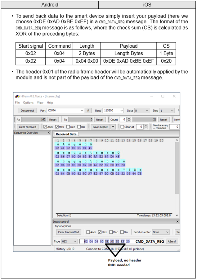

To finalize the connection setup, the notification enabled message has to be send. With this feature, the peripheral device lets the central know, when there is new data, which is important for bidirectional data transmission. After this step, the channel is open and data transmission can start.
For the description, we assume that a smart phone is the initiator of the connection. Thus, it acts as central and the Proteus module acts as peripheral in figure 3.

This chapter describes how to setup a connection to the Proteus module in command mode, when a smart phone and the nRF Connect App are used. Please perform the following steps:
