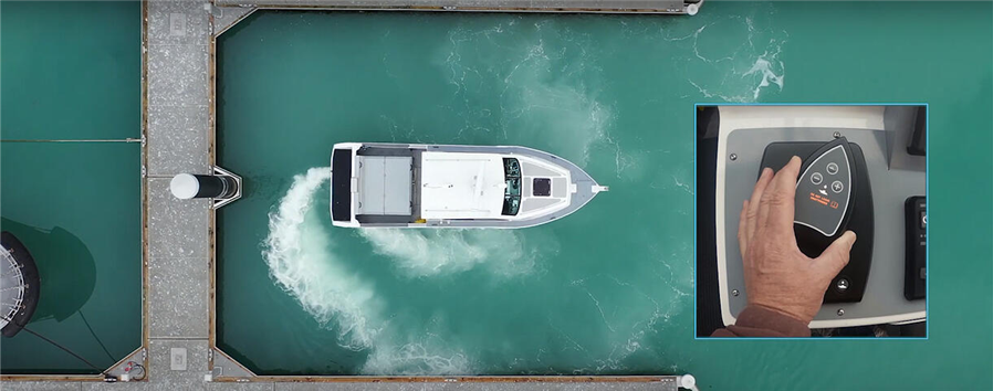

This property of waterjet propulsion enabled HamiltonJet to develop a sophisticated system for automatically performing 'station keeping' – the mariner's term for staying motionless on the surface of the water while maintaining a constant heading.

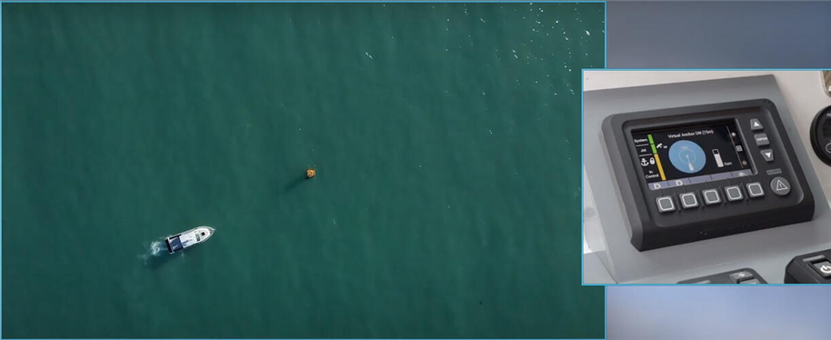

Its JETanchor product for station keeping, or providing a 'virtual anchor', is an optional feature of the AVX propulsion control system. Playing a vital role in the JETanchor's position sensing system is an MTi-2 Vertical Reference Unit (VRU) from Xsens.

In other words, this swinging of the mast introduces error into the GPS signal. The role of the MTi-2 VRU is to measure the hull's roll and pitch. Once the mounting positions of the GPS receivers and of the VRU are programmed into the AVX control system, sophisticated JETanchor algorithms apply calculations in real time to cancel out the error in the GPS signals induced by movement of the water, resulting in a clean position signal. This then enables the waterjet propulsion system to minutely adjust the position of the hull on the water at a rate of ten times per second.

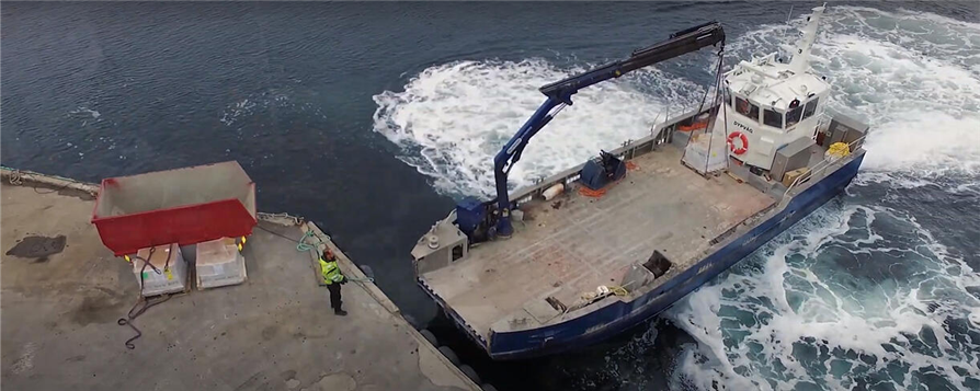

The accuracy and stability of the MTi-2 VRU play a crucial role in enabling the JETanchor product to achieve high performance. It can typically maintain a vessel's position to within 1m at sea. System tests have demonstrated the system's ability to maintain a cargo vessel's station 1m from a wharf while a 1 tonne load of bricks was lifted by crane to shore.
