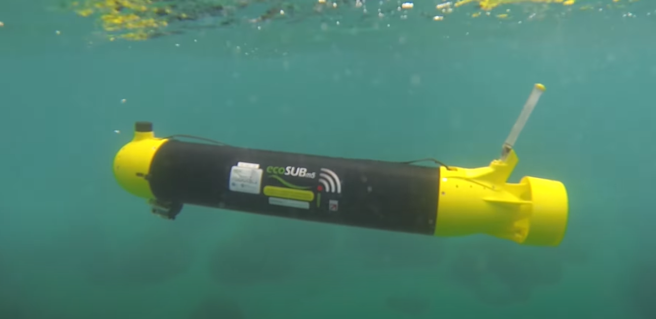

UK-based marine products supplier Planet Ocean spotted that this left a gap in the market for a smaller, more affordable AUV. This realization spurred the development of ecoSUB, a range of small, low-cost AUVs which can be easily carried, launched, operated and retrieved from the water by a single person.
Its goal was to democratize the use of AUVs: to bring them within reach of all research institutes, universities, commercial users, users in less developed countries, and of other users who have limited resources.
It turned out that the design of this innovative AUV required a motion tracking sensor which was both compact and accurate.
Capture 2
Xsens makes accurate underwater navigation possible
The efficient operation of the ecoSUB AUV calls for accurate location data derived by the dead reckoning technique. On the surface of the water, geolocation is easy: satellite positioning signals determine position to a typical accuracy of ±5m.
The satellites’ RF signals do not penetrate water, however, so the ecoSUB AUV determines its position by continuously tracking its motion relative to its launch point on the surface.
For this motion tracking function, ecoSUB uses the Xsens MTi-3 AHRS (Attitude and Heading Reference System), together with a discrete pressure sensor for depth measurement. The MTi-3 sensor provides the ecoSUB with highly accurate measurements of roll, pitch, heading and acceleration.
The ecoSUB’s on-board computer continuously converts these measurements into position coordinates.
The especially challenging requirements of designing a small and light AUV made the Xsens motion tracking sensor the ideal fit.
‘The fundamental design objective for the ecoSUB was to make an AUV that was small and light enough for an average person to lift, while still having enough load-carrying capacity and range to perform useful tasks. Our design for the ecoSUB fits an “A” size sonar buoy tube – it is 1m long, and weighs just 4kg. To optimize the ecoSUB’s range and dynamic characteristics, we needed to apportion as much of the internal space as possible to the battery and the motor. So the motion sensor and the rest of the control electronics system have to be packed in a small space, in the presence of the strong magnetic fields generated by the motor system. And of course the accuracy of the AUV’s position data is absolutely crucial. When the AUV is being used for instance to detect an oil leak or to monitor variations in the oxygen content of sea water, users need to know exactly where in three dimensions it has taken its measurements.’
Jeremy Sitbon, ecoSUB Chief Robotics Engineer
