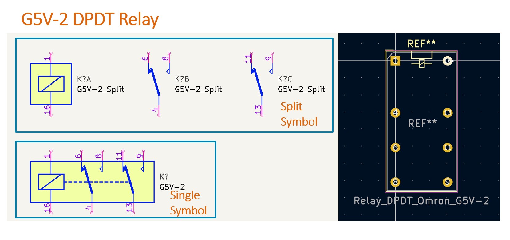

I am moving from generating PCB layouts using Fritzing to KiCAD. It has been something I have been considering for a while. I have been investing some resources (time, money and energy) in learning KiCAD 6. I have just completed the module on constructing your own symbols. This has some appeal to me, I've done some research on the topic and would like to get feedback from member that have some experience with KiCAD.
Here is the scenario. I have recently started using a DR21A01 relay module. I would like to have a symbol to call the module in KiCAD. My first thought is someone must have already done this. It doesn't seem realistic that individuals using KiCAD are constructing a symbol for this module when they need it.
The site I purchased the units from has a schematic of the modules. None of the KiCAD symbols sites I have visited has a symbol for such a module. What am I missing? Are my expectation to high? Maybe a reputable site provides the resources to support the product. I tend to buy in markets that have the cheapest price. That doesn't necessarily mean you get all the things you need.
I'm thinking components like this should have CAD modules that can be incorporated into designs. Yes/No?
Since I have limited experience with KiCAD I hoped those in our E14 community would share their knowledge. I did a search for an IR sensor modules I use often. Again nothing supported in a CAD. Maybe I am looking in the wrong place.
Do all KiCAD users just bang out their own. Seems rather labour intensive.
Chime in with your thoughts. I'm eager to learn.

    Having to develop schematic symbols and footprints is not uncommon, especially for inexpensive modules made in China. Schematic symbols can be developed pretty quickly once you get the hang of it, footprints…

    For any of these "modules", I would rarely expect an eCAD program to have a library footprint for them. That said, personally, I have never seen this module before. And I'm going to guess others haven…

    shabaz over 4 years ago in reply to colporteur
    It might be a very popular module for prototyping on stripboard/perfboard/breadboard, where the 0.1" pitch is useful.
    For a PCB project, there are popular relay footprints already in KiCad, and a transistor and diode and resistor is easily added.
    This relay for example: 5V DPDT Relay is $2.38 so more expensive than the module, but there are similar footprint (datasheet) alternative relays are also available from Aliexpress, which are cheaper than the module by far; this is about $2 for five of them, so $0.40 each:
    The transistor, diode and resistor will be very cheap too.
    In KiCad, the symbol and footprint for G5V-2 matches these relays (many relays will match that footprint, it's fairly standard). There are already single and split symbols for it in KiCad.
    By doing this, you'll save costs for the PCB version of the project, rather than using the module. Granted you lose the ability to easily unplug the module, but you might be able to find turned-pin sockets that accept the relay (might need the holes widened in the footprint to insert the sockets however). It might be more reliable too, since the relay module is only tethered from one side.
