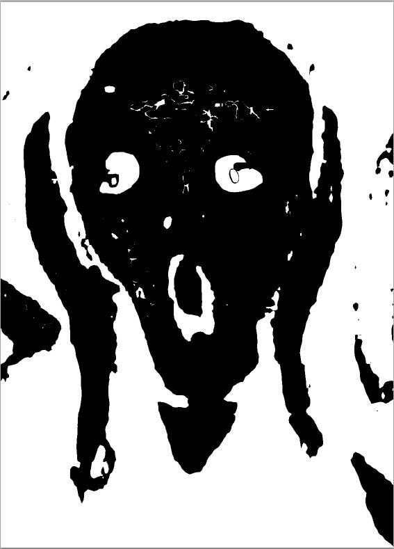

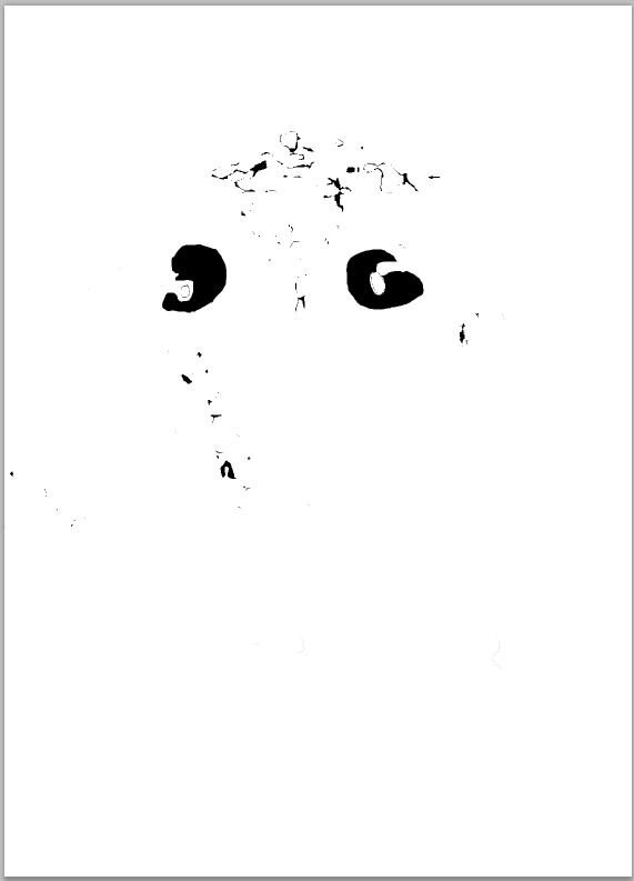

Next prepare the layers that will be used in KiCad.  The layers are copper (both bare and covered by other layers), mask, and silk.  To do this, combine the layers as shown at the bottom of the palette and convert them to a B&W image.   I used png file format set to 400 DPI and roughly the size I wanted (1 x 1.5 inches).  The resulting images are shown below.
{gallery} Layer Images Converted for KiCad
REPLACE THIS TEXT WITH YOUR IMAGEimage
Silk
Mask
Copper
The work flow in Illustrator demonstrated by Andrew is much different and judging from the video has advantages.  However, my method proved quite workable.
