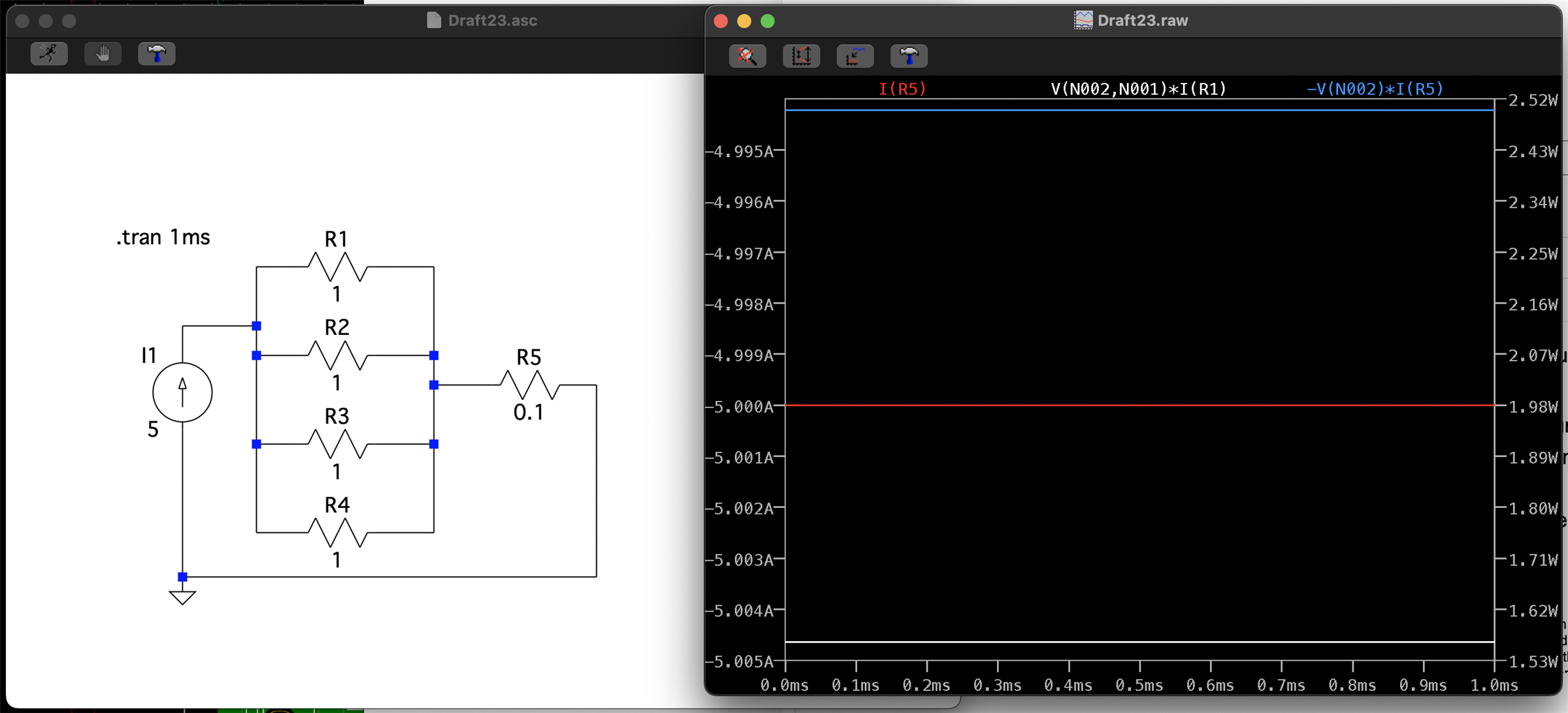

Jon mentioned using Thick Film resistors instead of the wire wounds I have because they have lower inductance - in fact, looking at data sheets, it would seem to be negligible inductance.  This doesn’t seem to be a parameter reported on wire wound resistors so I can’t compare.  I could use this 1Ohm Thick Film resistor , which has a much better temperature de-rating and coefficient, instead of the 1 Ohm wire wound resistor.   With some adjustment to the run of the -5V trace, I could get this to straddle the trace linking R20, R17, R14 and R10.  Worth it for an extra £18.50?
I did a quick check with LTSpice to double-check the power requirements of the resistors as well: approx 2W.  I’m rubbish at LTSpice though, so it could be wrong…
LT Spice schematic with run results showing power used by the 1Ohm resistors on the source of the MOSFETs at 5Amps
This is showing just over 1.5W at 5A.

    How odd. Somehow, I totally missed seeing the white line. Not sure how I did that - probably, it was your "approx 2W" steering me to the wrong lines. Sorry about that (I blame it on old age!) I still…

    Re: the 1R sharing resistors
    For 5A, each resistor handles a quarter of that: approx 1.25A. Power is I^2 x R, so about 1.56W with a 1R resistor. (Your simulation is giving you the dissipation of the 0.1R sense resistor.)
    These parts in the following link can manage 2W, but will be running hot on 1.25A and it might be problematic, depending on how high the ambient in your enclosure gets.
    https://uk.farnell.com/panasonic/erjc1bf1r0u/current-sense-res-1r-1-2-w-2010/dp/2353353
    To get the dissipation in each device down, you could place two in parallel to give 0.5R in series with another pair to bring it up to 1R again. That would then quarter the dissipation in each resistor, but then the cost is getting towards what you'd pay with the one you've found (though it would make for a neater build on the board).

    The simulation shows both Jon, with the 1Ohms at the bottom around the 1.56W mark.  I’m not sure why I wrote 2W above the image and 1.5W underneath it: excessive rounding I think.  Those parts you linked to are about half the price of the one I did, but there were cheaper ones - mainly it was the footprint that allowed me to straddle the trace!  I vacillate on using the board I have because all the high current parts are connected through 0.5mm thermal relief traces and I should just bite the bullet; on the other hand I can check the circuit works and make further adjustments.  It obviously makes sense, but plenty of time yet as I’m very slow on developing the control side.
    I still think my InHead simulator is quicker; though I would have guessed an approximate 1.6 for the square of 1.25 rather than bother to calculate it properly.
