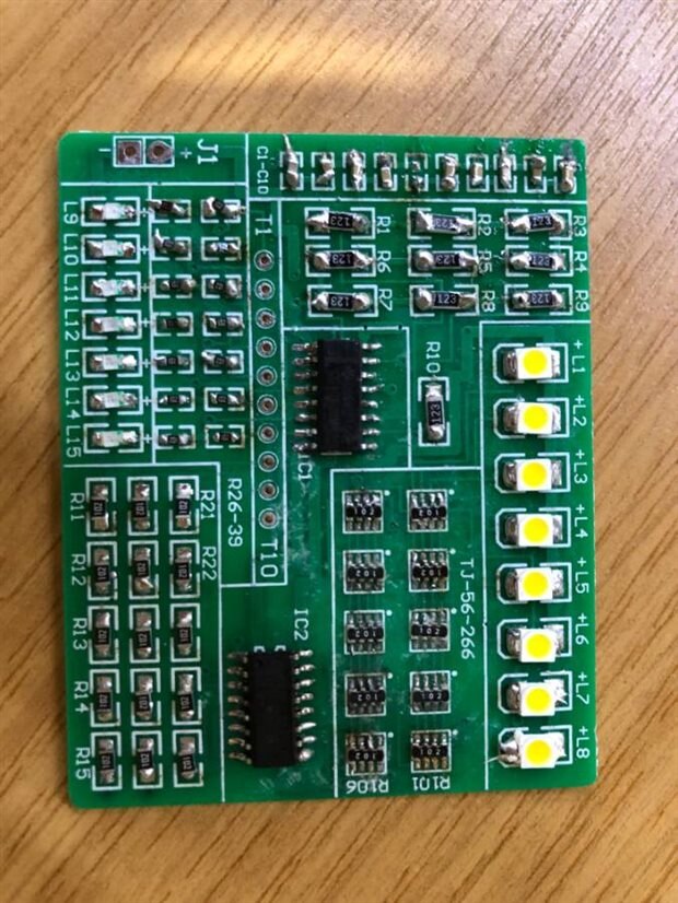

    Andrew J over 7 years ago in reply to Fred27 +9
    I can do you a photo, I'm not ashamed . Don't look too closely at the Capacitors though - those were (some of) the evil 0603s, one of which has gone on holiday. This was all done by eyesight as well.

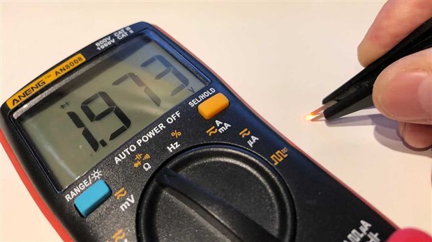

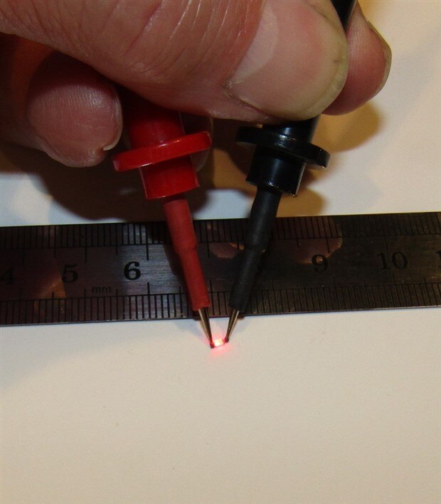

    jw0752 over 7 years ago +8
    Hi Andrew, I think you did a pretty good job too. With respect to the LEDs I always use a small analog multimeter set to R X 1 to test and verify polarity on small difficult LEDs. In the case of my analog…

  • 14rhb
    14rhb over 7 years ago in reply to Andrew J
    Wow, are you sure this is your first go at SMT? It is really good.
