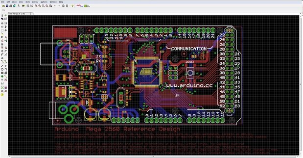

Schematic and Board Design Software
There are dozens of PCB CAD software available for you to design your first PCB with, but three stand out in terms of ease of use for first time designers. I have used each of these three programs in the past, and I have a preference for Eagle CAD, but am beginning to use CircuitMaker and KiCAD more as their community support grows larger.
Eagle
Autodesk EAGLE, (formerly CADSoft Eagle which was owned by Element14) is billed as the Easy Applicable Graphical Layout Editor that is a powerful, easy-to-use PCB design software for every engineer! For more than 25 years, EAGLE has been the PCB design tool of choice for hundreds of thousands of electronic design engineers and developers worldwide. Many enthusiast have used eagle over the years due to its large community support and it’s limited but, free hobbyist license. Eagle also has a monthly and yearly subscription plan set up at two different pricing tiers for those looking for a more feature rich version of the software. For the purpose of this article, the focus will be on the free version.

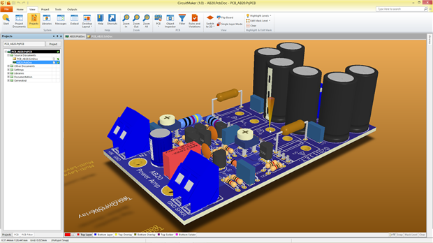

CircuitMaker
CircuitMaker is Altium’s foray into the free PCB CAD world, and I honestly have to say that they knocked it out of the park. Its website says that CircuitMaker was designed “For turning great ideas into real products, you need design tools that won’t limit your imagination or hold you back. CircuitMaker has all the power you need to design high quality schematics and Printed Circuit Boards, with no artificial limits on layer counts or board area. Best of all it’s free… Typically, free EDA software is poorly developed, or has restrictions on design size that render it useless for any real project. Not CircuitMaker - you get the full power of 16 signal + 16 plane layers, and no restrictions to the PCB dimensions. You can even make money with your designs, because it is nit restricted to“non-commercial” development only!”
CircuitMaker is the newest player on the field, at least as far as this article is concerned, and it boasts a wide array of interesting and useful features that have raised the bar in terms of what users might expect in a free PCB design program. The software is based on Altium Designer’s technology, but at a more hobbyist friendly level. I will admit that this is the design program that I have used the least, but it is quickly growing on me thanks to some of its features such as the ability to easily collaborate on a project with other makers thanks to its Share and Collaborate feature. One other feature I would like to highlight is the program’s native 3DTm technology that allows you to press a hotkey at any point in the board design process and view the board and components rendered in realtime 3D. This allows you to see any component clearance violations and you’ll even know what the overlap distances are, so you can get your designs right - and fit to the box - the first time.
Other standout features of CircuitMaker are:
        • A massive, and rich component library
        • Push-N-Shove Routing
        • Topological Autorouter
        • Multisheet Schematic Editor
        • A very powerful DRC/DFM Processor
        • The ability to import from virtually every other popular PCB design program.

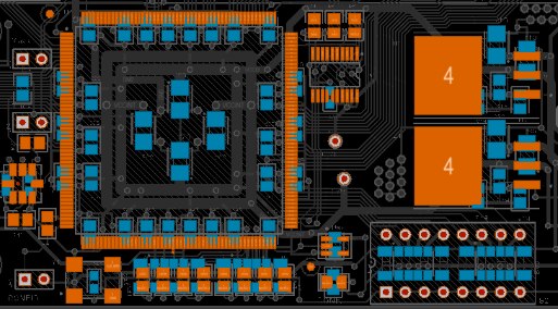

Laying out the PCB
Mounting Holes and Other Routed Features
If your design features mounting holes, v-scores, mouse bites, or fingers, make sure you place them on the board first. This would also be a good time to read over any documentation that the fab house that will manufacture your boards provides. Some facilities have guidelines you will need to follow that will govern the sizes of drilled holes, clearance requirements for v-scores, and even rules that govern finger placements. Placing these features at the beginning of your design will also help eliminate any issues that might arise when placing component footprints into the design.
Component Footprints
Every PCB design program is different when it comes to footprint assignment. Some programs force you to select a package or “footprint” when choosing schematic components, others let you assign a footprint to a specific schematic symbol in your design. Either way works fine, but it is important to remember that the footprint you use must match the physical component you will be populating the PCB with. An incorrect footprint will almost always result in wasted time and money.
If you are doing a small run of boards, this is not that big of a deal, as you can either remake the boards, or order the same component with the correct footprint. On larger runs, it will be up in the air on which solution is the better option based on which component does not fit. If it’s a $0.01 resistor, then it's not a big deal, but if it is an $8 IC, it could be disastrous.
All three of the programs listed above feature the ability to create, edit, and import footprints, but this process is tedious, and I find it best to try and find off-the-shelf components that match existing footprints. With that said, on the last PCB I created, I did have to create footprints for 3 different components, and it only set me back a few hours to get those components created.

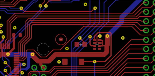

Trace Width vs Amperage?
One often overlooked step in the PCB design process by newcomers is selecting the proper trace width for the load it is intended to handle. Traces for simple 3.3V and 5V logic signals can be tiny, but the trace for high voltage connectivity from something like a 120V 10A relay will need to be much larger to ensure they can handle that type of load without melting and destroying the PCB.
This is not an area I am an expert on, so I will have to refer any questions on this topic to the internet or electrical engineering text books. There are several handy calculators online that will help you figure out proper trace width. There are also methods to boost a trace’s power capacity such as leaving the trace in question exposed from the solder mask, and giving it a liberal coating of solder in the wave soldering process. I am not sure if this method is considered a best practice or not, but I have seen it used in amateur and professional PCBs.
Routing The Traces
This is another point in the design process where you should read the documentation provided by the fab house that will be manufacturing your PCB. Every manufacturer is different, and some of the cheaper houses have restrictions on how small your traces can be, as well as how small the clearances can be between traces.
You can choose to hand route each trace or use the program’s auto routing feature. If my design is small enough, I prefer to route the traces by hand, but this can become highly time consuming if your design is complex. One thing to note is that sometimes the Auto Router will miss routing a trace or two, and you should always double check that every net from the schematic has been properly routed on the board design. Each program has various settings you can change that govern the amount of vias and layer changes that will be used to route each trace. This is important as some fab houses will charge extra if the number of vias in a design crosses a predetermined threshold.

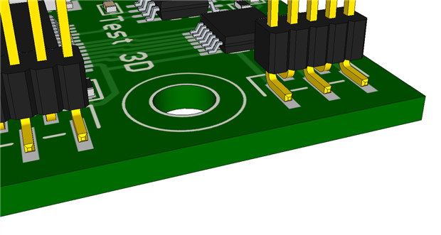

Check 3D Rendering
Step two in the Q&A process is to utilize your design software’s 3D rendering feature to check for component clearance issues and that the silkscreen layer is correct and is free of obstructions that component packages might have caused. This is also a good time to take a screenshot of the render so that you can brag to your friends about how cool your new PCB is going to look. I find it best to look at both the naked board, and the populated board in the 3D view as it gives me a better sense of confidence that my design is sound and ready for manufacturing.

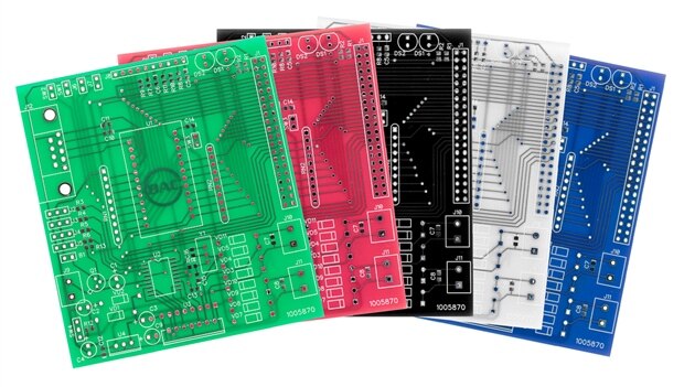

Having your PCB manufactured
The first thing you will need to do before you can ship your design off to be manufactured is to generate a Gerber file that contains all of the necessary design files for the fab house to use in the PCBs production. This file is a universal file that is generated in the CAD program you used to design your PCB. Each program has its own way of generating this file, so be sure to read the program's instructions, or search for the proper way to generate the file with the program you are using.
Once you have the design file created, I am going to assume that you have a fab house picked out. This is something you should have done before running the DRC earlier. You will then need to visit the fab house’s website and select the number of boards, the PCB material and thickness, solder mask color, silk screen color, and the type of coating you would like applied to the copper traces. The most common coating is called HASL and is simply a method used to coat the copper traces in a thin layer of solder that will prevent them from oxidizing and compromising their integrity. If you have fingers on an edge connector, you will want to specify in the notes that these copper pads do not get a HASL coating, unless required by the design.
Once you have all of the various options for your PCB selected, all that is left is to finish up the order, and wait for your PCBs to arrive. This could take anywhere from days, to weeks, or even months depending on the fab house you select. Some of these manufacturers offer expedited services for an additional fee, and this is something you should consider when choosing who will manufacture your PCBs.
One other factor to consider is how many PCBs you will be having made. Some fab houses have a minimum of 100 PCBs that must be ordered, while others will accept orders for as few as five boards. I have seen some places that will manufacture a single PCB, but you will have to wait on a panel to be filled up with other peoples designs before the manufacturing process will begin. These single board services are notorious for taking weeks to months to deliver the single board, so consider spending the extra money if you need your board fast.image
Finally, most fab houses will include an electrical signal check on the PCB at various test points for free, but a thorough electrical signal check of all of the traces will cost extra. If you are confident in your design, and you are just ordering a few PCBs, the free testing should suffice, but if you are having more than 10 boards made, or are planning on selling the PCBs you should consider paying for the more thorough check. You could also perform this test yourself by building a testing jig with pogo pins.
