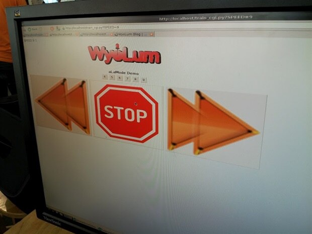

A web interface was running on the Raspberry Pi to allow users to control the train:
The Pi would then sends commands over serial to the Arduino sketch running on the Alamode to control the motor shield.  Here's the demo in action:
