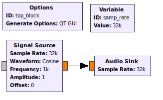

My objective was to write a tutorial for the GNU Radio application using a Raspberry Pi. After successfully building two GNU Radio flow graphs on my Ubuntu 18.04 i7 processor desktop, I ported the flow graphs to a Pi3B+ connected to an HDMI with audio monitor. One flow graph is an audio signal generator outputed to a speaker. The second is an FM receiver. Both flow graphs work in the sense they produce audio but with distortion and in the case of FM broadcast, unreadable.
The audio flow graph requires a GNU Radio software installation. The FM flow graph requires an SDR dongle to gather a broadcasted signal to feed the GNU Radio FM radio receiver flow graph. The test will be using the audio flow graph since no additional hardware is required.
cstanton  has agreed to use his Pi4(2G) to run the test. Before starting the exercise, I will ask Christopher to review review the procedures and provide feedback. I'm keeping the the verbiage terse, assuming a higher level of understanding. If more details are required or feel something is more appropriate or missing please let me know.
A zip file of two flow graphs is attached. The file with basic is minimal as it gets. The second file provides a test module. I experienced a problem with both.

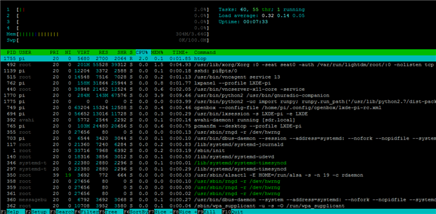

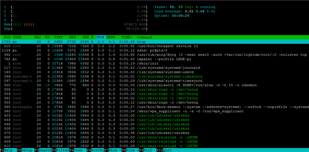

Take screen shots of htop screen at the following milestones.
1. O/S idle, no application running on the GUI desktop other than what is defaulted.
2. GNU Radio started, no flow graph
3. GNU Radio flow graph loaded.
4. GNU Radio flow graph started.
5. Evaluate audio coming from speaker and advise.

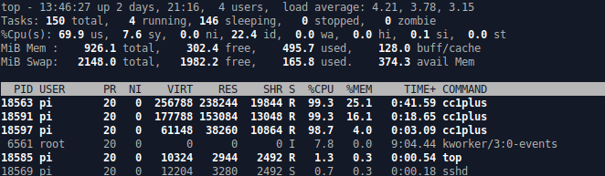

    My premise is that I will no longer use Python 2 since it is deprecated; all of my projects are now converted to Python 3.  What I described previously was what I did for an x86/x64 APT-based Linux system like one of the *buntus or debian.  On my Xubuntu x64 build, it worked perfectly.  Clearly, this is not appropriate for a Raspberry Pi.  So, I'll see what I can do on my Raspberry Pi 3B (don't have a 4 yet) which boots and runs from a USB disk (relief from using a MicroSD which I highly recommend!).
    This is what I found for the Raspberry Pi: https://wiki.gnuradio.org/index.php/InstallingGRFromSource_on_Raspberry_Pi which leads you to https://wiki.gnuradio.org/index.php/InstallingGR#To_install_system_wide as part of installation.
    I did this because the existing Raspbian Buster does not yet have a Python 3 oriented package for gnuradio; this is a "build from (github source") exercise.  Certainly, gnuradio 3.8.0 (latest github version) will eventually find its ways into all of the repositories.
    On a Raspberry Pi 4, building from source is MUCH faster, I would imagine! image
    If you are not worried about excess heat and freezing up, when you get to the `make` step, use the -j parameter for specifying more than one CPU cores.  I used `make -j3 # 3 CPU cores` since my Pi is otherwise idle at the moment.  It feels cool to the touch but, then again, it is not a Pi 4.
    Version: The CHANGELOG.md file on github indicates that this is [3.8.0.0] - 2019-08-09.
    Python flavor: I selected Python 3 per instructions (recommended). I did not try Python 2.
    Differences in GRC between Pi and Ubuntu: Going to be looking out for this.  Thanks for the heads up.
    Begin make step at 13:25 USA CT.  I'll report when the make step ends. Time for tea and scones.
    e14 Contributor over 6 years ago in reply to e14 Contributor
    At 14:05 USA CT (40 elapsed minutes), I am 33% of the way through the make (compiles).  So, my estimation is that this will take 120 minutes from start to end on a Raspberry Pi 3B with a USB disk and using 3 of its CPU cores.  In theory, I should be done around 15:25.
    CPU Speed 1200 Mhz | CPU Temp 85 °C
