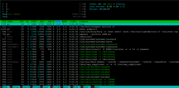

cstanton  has agreed to use his Pi4(2G) to run the test. Before starting the exercise, I will ask Christopher to review review the procedures and provide feedback. I'm keeping the the verbiage terse, assuming a higher level of understanding. If more details are required or feel something is more appropriate or missing please let me know.

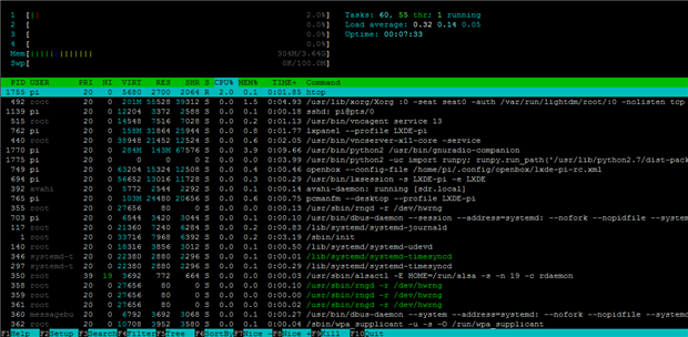

Take screen shots of htop screen at the following milestones.
1. O/S idle, no application running on the GUI desktop other than what is defaulted.
2. GNU Radio started, no flow graph
3. GNU Radio flow graph loaded.
4. GNU Radio flow graph started.
5. Evaluate audio coming from speaker and advise.
