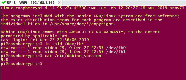

I placed the sense hat on an RPi 3B+ and get a nice rainbow display on the LED.
When I run the snake example, I get the message "Error: cannot open framebuffer device."
I run in debug using Code::Blocks, and I see that the code apparently finds the joystick.  So the frame buffer is not the first thing I checked.
My RPi is nearly virgin.  I have installed Code::Blocks and the sense hat.  Raspian is up to date.  I enabled VNC, SSN, SPI and I2C.
I am working headless via a VNC window in W10.
Is there an incompatibility between a RPi 3B+ and the sense hat?  I am seeing that it is compatible with RPi 3B  (no +).
If not, would somebody offer a suggestion for getting snake to get past this error?
Thanks.

    Hey, I fixed it.  I know what I did, but do not understand it.
    In boot config.txt, I commented out the dtoverlay just under [all] and added in the present, as suggested in another thread:
    https://lb.raspberrypi.org/forums/viewtopic.php?t=192033
    [pi4]
    # Enable DRM VC4 V3D driver on top of the dispmanx display stack
    #dtoverlay=vc4-fkms-v3d
    max_framebuffers=2
    [all]
    dtoverlay=rpi-sense
    What did I just do?
    What is vc4-fkms-v3d?
    Did I just get sense hat to work, but now fouled other components?
    Why do I have a section for pi4 when I installed on a pi3?  I do not recall specifying pi<anything> during install.
    Thanks for any tutoring on dtoverlay.

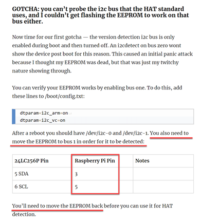

    shabaz over 6 years ago in reply to osenjw
    Hi John,
    Linux uses a more complicated than necessary method to configure up hardware, and the Pi uses a more complicated method than needed on it's accessory boards like the Sense HAT. What's occurring is that a serial bus (I2C) is queried at boot time, and the I2C memory chip on the Sense HAT reports back that it is plugged in. At that point, drivers can be loaded by looking up a file containing a compiled 'device tree overlay', that will be part of the Raspbian image. After that occurs, the end result is that a /dev/fb1 gets created. That's not a normal file, but more a special gateway into controlling the LEDs. Since it is a special file, it cannot be successfully used by copying like a regular file on the file system. If you were to power off, unplug the Sense HAT and restart, then that /dev/fb1 would disappear, since the I2C memory chip would be disconnected.
    On the Sense HAT, there's some microcontroller (I've never checked the detail) but I believe it perhaps accepts commands from the Pi and transforms to LEDs being illuminated via an LED driver chip. So, at power-up, you're seeing the rainbow pattern for several seconds on the LEDs as a result of the microcontroller booting up and running some internal sequence. If you see that pattern then it's likely the microcontroller is fine, and the power supply is fine too. (incidentally, there's no guarantee when a 5.0V phone charger is used that it will function, because the Pi official supply doesn't output 5V, it outputs 5.2V over thicker-than-normal wires, and that plus the 0.2V voltage difference can be critical under heavy load). The Pi official supply is a terrible mobile phone charger, but a good-enough power supply. In contrast, a mobile phone charger is often bad for Pi powering, but excellent at phone charging. In a third category, if your PSU is some third party make but specifically designed for the Pi, then you're likely ok.
    By you adding the lines to config.txt, you're forcing the Pi to load the device tree overlay file for the sense HAT, regardless of if the Sense HAT is detected (via the I2C memory chip) or not. If that's working for you, it suggests that the memory chip on the Sense HAT was corrupted. There are some instructions on how to reprogram that chip here: https://www.raspberrypi.org/documentation/hardware/sense-hat/
    However it states the instructions might not work on Pi 3B - maybe they have not tested the reprogramming steps on that board. Anyway, there's nothing wrong with manually adding the lines to config.txt to work around the issue, as you have done. It just means that even if the Sense HAT is removed and the Pi is restarted, the drivers will still be loaded (and that's likely not a critical issue in this case).
    I can't comment on why the vc4 bit is there, it could have been put there as a result of some other stuff being executed, or it may be normal (since the same Linux image gets loaded onto all Pi's). In any case, the '#' means it is commented out and not active. My Pi 3 (not Pi 3B) doesn't have any entry with vc4, commented or otherwise.

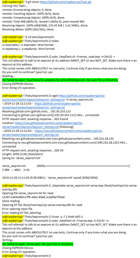

    osenjw over 6 years ago in reply to shabaz
    Thanks for the obvious time and thought you have put into your answers.
    I attempted the process found in:
    I captured the output found below.
    It appears that the script is looking for a device that is not there.  I checked the directory, it looks like it is of a different structure than expected.
    The structure is good through 12c-0, but then it looks like many subdirectories.  Some of them appear to be logical links back to somewhere previous in the directory chain.
    I include the dump below, on the off chance it suggests an obvious answer to you.  Otherwise, I think I am satisfied with what I have.  I can mess around with the sense hat now.  Giving me a sense (pun) for how appropriate RPi+Sense is for my course concept.
    I did look at the schematic.  I believe the only EEPROM is 64 bytes on the ATTINY88-MUR.  I think this chip comes in 4 or 8KB of FLASH.  This is pretty tight.  Probably not enough room to sense EE corruption and correct it.  I doubt whether some change in the AVR causes the issues below.  I would guess the directory structure changed so the script is no longer valid on the 3Bx.
    Hi John,
    It might not be possible without some jumper wires and manually moving the I2C bus. The Pi has two I2C interfaces, and the EEPROM is on the other one compared to all other I2C devices on the board.
    According to this link: https://www.madebymikal.com/raspberry-pi-hat-identity-eeproms-a-simple-guide/
    I don't know for sure though, I've never tried it. Another possible scenario is that the EEPROM chip (it is labelled U6 on the board) is faulty, or isn't soldered on correctly.
    Shabaz,
    You have been a great source of information and mentoring.
    I throw in the towel.  I have a configuration that can let me play with both python and C in exercising multiple sensors.
    In my day job I am responsible for a field a service tool.  It services 70+ base machine models using ~40 controller types.  In no case can reprogramming be interrupted, or a controller taken 'out of the box", without my service tool being able to configure it appropriately for the intended machine.  That includes setting EEPROM default values.  In some cases, very similar to the one we believe exists on my sense hat, my program will catch corrupted EEPROM and restore a default value.
    So I am a bit surprised the RPi does not have a requirement for HAT developers to include in the installation process a "restore HAT to default valutes" script.  Such a script would detect the RPi motherboard, revision of HAT and do the right thing.
    I am also surprised that the sense hat got off of end-of-line testing with EEPROM corrupted.  As there are other posts on this, I am not the only one.
    I have spent over 8 hours wandering through forums.  Luckily I bumped into you, and you took the time, such that I reduced the problem to the EEPROM is corrupted.
