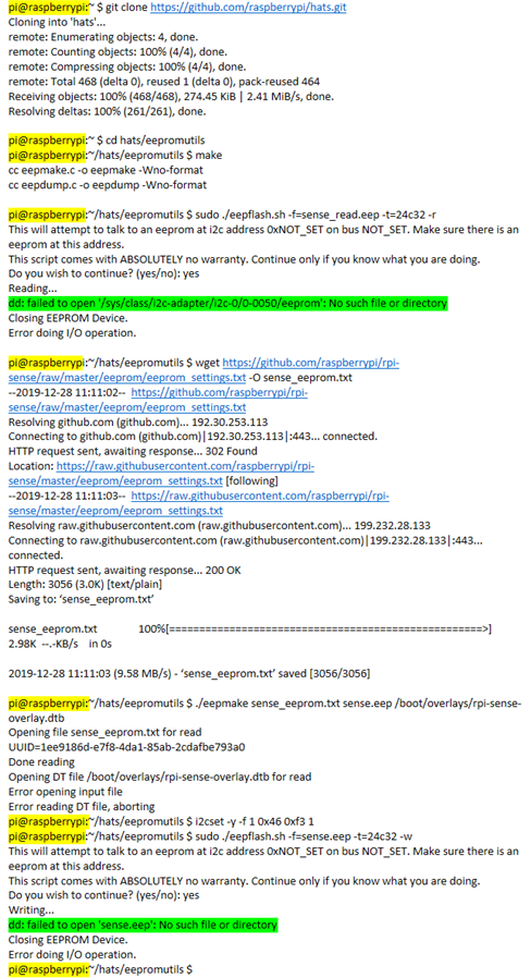

    I attempted the process found in:
    https://www.raspberrypi.org/documentation/hardware/sense-hat/
    I captured the output found below.
    It appears that the script is looking for a device that is not there.  I checked the directory, it looks like it is of a different structure than expected.
    The structure is good through 12c-0, but then it looks like many subdirectories.  Some of them appear to be logical links back to somewhere previous in the directory chain.
    I include the dump below, on the off chance it suggests an obvious answer to you.  Otherwise, I think I am satisfied with what I have.  I can mess around with the sense hat now.  Giving me a sense (pun) for how appropriate RPi+Sense is for my course concept.
    I did look at the schematic.  I believe the only EEPROM is 64 bytes on the ATTINY88-MUR.  I think this chip comes in 4 or 8KB of FLASH.  This is pretty tight.  Probably not enough room to sense EE corruption and correct it.  I doubt whether some change in the AVR causes the issues below.  I would guess the directory structure changed so the script is no longer valid on the 3Bx.

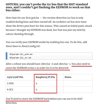

    It might not be possible without some jumper wires and manually moving the I2C bus. The Pi has two I2C interfaces, and the EEPROM is on the other one compared to all other I2C devices on the board.
    According to this link: https://www.madebymikal.com/raspberry-pi-hat-identity-eeproms-a-simple-guide/
    I don't know for sure though, I've never tried it. Another possible scenario is that the EEPROM chip (it is labelled U6 on the board) is faulty, or isn't soldered on correctly.
