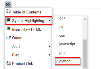

    How did you display you code so cleanly in your post? The numbering and ability to scroll within the message is ideal. Can you share your insight?

    And, to display the code I used the Syntax Highlight and used Tab to align it (spaces work too)

    Thanks for the cut and paste on inserting code. I will definitely use the feature. Making it easy for readers to view code is one step to improving the chances of getting an answer.
