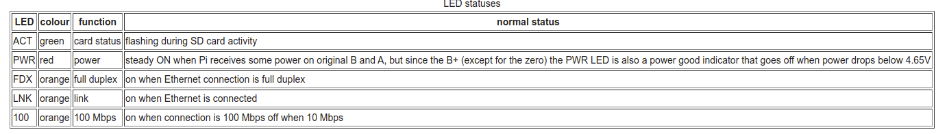

Hi, recently i have bought raspberry pi 4 B and it was working fine.But yesterday I have tried to run 4 dc motors with l298n but suddenly the pi was stuck and i have restarted it after restarting it was booting but red led(power led) is not working or not on but pi is booting.so what is the problem. does anything damaged in my raspberry pi.Is it safe to use now .i have checked the gpio pin 4  and the i am getting voltage from the gpio. so why my red led is not working .please anyone help.

    The voltage measurement across the two GPIO pins was to determine what the Pi 5V power supply is reading. I'm wondering if the Pi 5VDC supply is above 4.5 https://elinux.org/R-Pi_Troubleshooting#Red_power_LED_does_not_light.2C_nothing_on_display   to cause the light to come on. An LED across the pins may light with just a little voltage. It is not an indication of the supply.

    The Red LED indicates power. If it is blinking or off, your voltage from your supply is insufficient. You need a 5V 3A supply for the Pi4 - anything less is asking for instability and problems. Also, low quality cables cause voltage drops - so I'm not surprised you have this issue supplying the unit with just 1A (just a third of what is needed).

    Great catch L-G noting a 5VDC @ 1amp power supply is under rated to power a Pi4B. I didn't see the trees for the forest. TSG indicated it was working. I took that to mean working with the appropriate power.

    SG, as L-G is pointed out, their are specific power supply requirements for a Pi4B. The specification are higher than early models of Pi's. A 1amp power supply is from the days of the first Pi model. You need to confirm the power supply specifications to see if that may be causing your issue.
