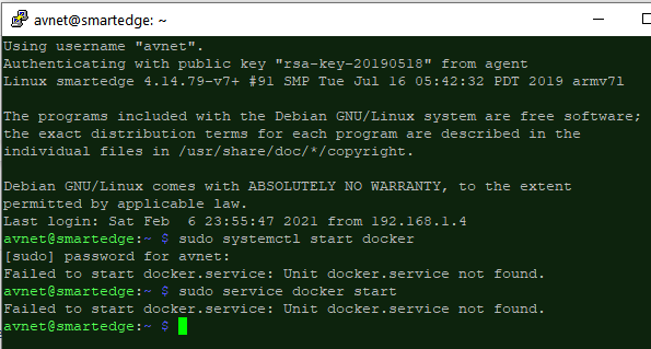

    For the Avnet SmartEdge IoT Gateway which running on the Raspbian GNU/Linux 9.13 (stretch), there is not need to install docker, you need to enable it on the systemctl  using the following commands:
    1. systemctl : $ sudo systemctl start docker.
    2. service : $ sudo service docker start
    3. run the command: “sudo docker run hello-world”

    Jan Cumps over 5 years ago in reply to andynd
    andynd  wrote:
    Hi Ayman,
    I checked the 2019 and 2020 images but I didn't find the docker.socket or docker.service in these image to start/enable. Can I know what is your image you are using? I used below image link.
    https://avtinc.sharepoint.com/sites/Smartedge-iiot-gateway/Shared%20Documents/Forms/AllItems.aspx?id=%2Fsites%2FSmartedg…
    Thanks.
    I'm running the 2020 image too, and don't see docker.
    ayman.jehad, is it possible that you had to install docker as prerequisite for some other software package you are using?
    It does not seem to be there by default.

    tdp1985 over 5 years ago in reply to Jan Cumps
    Hello,
    Have you foud a way to inbstall docker on the Avnet SmartEdge IoT Gateway. I have also some errors :
    root@avnetiot:/home/avnet# systemctl start docker
    Failed to start docker.service: Unit docker.service not found.
    root@avnetiot:/home/avnet# apt-get install docker-ce-cli docker-ce

  • tdp1985
    tdp1985 over 5 years ago in reply to tdp1985
    Version :
    root@avnetiot:/home/avnet# lsb_release -a
    No LSB modules are available.
    Distributor ID: Raspbian
    Description:    Raspbian GNU/Linux 9.13 (stretch)
    Release:        9.13
    Codename:       stretch
