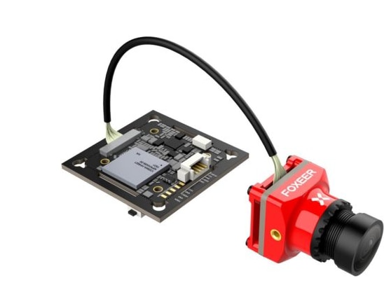

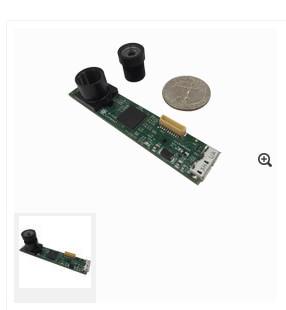

    These would both be good starting points I think.
    But I"m wondering how I would power them up to check the view though the lenses.
    Would I just plug them into my laptop as a webcam to get the focus or setting right ?
    Would I have to install special software to set them up ? Or specific "Drivers" ?
    The Foxeen has an actual cable instead of a ribbon cable which is better for my design

    As to your second question, some cameras can be tested via USB, but others require special interface boards. Especially those with high frame rates.
    USB cameras should readily interface with Windows or Linux, though you might have to hunt for drivers.
