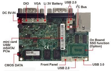

    Perhaps check out Femto-ITX SBCs - they are 55mm x 84mm and can rum Windows.
    Some of them don't have application connectors - just header connectors.
