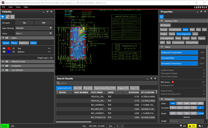

    Additionally, with the RPI Pico being OSH they do provide the orcad project files, but that's it. You have to download the free orcard viewer if you want to see how the RPI Pico PCB was designed. https://datasheets.raspberrypi.org/pico/RPi-Pico-R3-PUBLIC-20200119.zip
    I have included a few screengrabs of the Pico's layout that I used in a RoadTest:
    No ground pins! Only ground connection is through the thermal pad/slug, neat chip!
