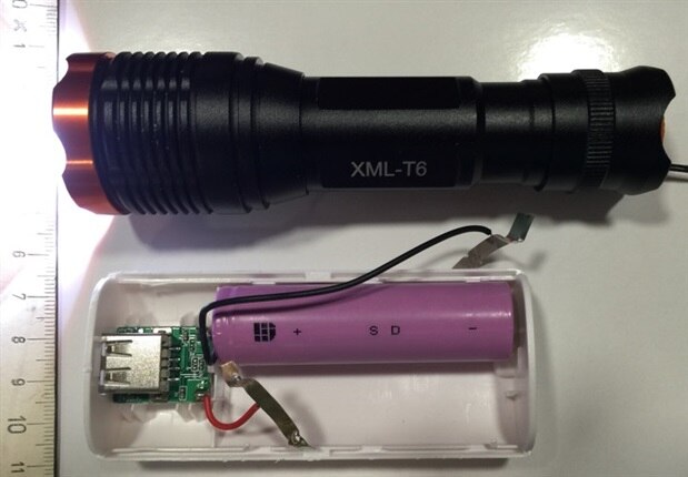

    Some thoughts about powering, recharging and light, if you want to build a lightsaber on a budget:
    I recently bought a flashlight (5-mode 1200-lumens Cree XML-T6 LED Flashlight for Outdoor FLD-144539) for $7.27. It has a solid aluminum casing, which could be incorporated directly into the hilt of the saber... as it already looks cool. Further it comes with an adjustable lens, which should allow you to adjust the light in your polycarbonate tube pretty good. The Cree XML-T6 led is a beast, so your saber should shine not to bad. Last item to salvage is the on/off button in the hilt of the flashlight.
    When I wanted to fire up the flashlight for the first time, I noticed, that it uses one 3.7V 18650 batteriy instead of an AA. A size I had not used directly until that. Having no 18650 laying around, the dimension of the battery made me think of a power bank I own and hardly use (Portable 5600mAh Power Bank for Cellphones EBTPH-334165 for $5.22)... opened it up and voilà: two 18650s... and even better: they where in a parallel configuration.
    This might be a solution to your power problem: two or three 18650 behind each other (but still configured parallel) give you ample mAh in an enclosure that still fits into children's hands. Salvaging the electronics of the powerbar gives you a USB-out and a USB-Mini-in: charge with ordinary USB-charger on the USB-in,  then power your Pi Zero directly from the USB-out – and the best of it: as the two 18650 are configured parallel, you might be able to directly fork some power for the Cree XML-T6 electronics/led taken from the flashlight.

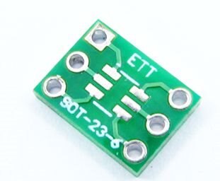

    If you're open to eventually creating your own PCB (with say EAGLE or KiCAD) then you might want to consider this very interesting TPS27081A power load switchTPS27081A power load switch. I've not used it, but I plan to do so. It is small but still hand-solderable. It seems perfect for where you want to switch a couple of amps at 5V, and can be directly controlled from the 3.3V logic levels from the 'pi. And it is cheap. Without a PCB, you'd need some adapter board though for a prototype, like the one below. Ideally you need a 1mm or 2mm sized soldering iron tip although bigger tip is still usable, it really isn't a super-tiny SMD part. If you need help with this, let me know - noticed you're in the UK, I'm not so close to your town but could solder it up if needed to a board. But worth trying it yourself if you can, because this is not an overly small part so definitely achievable with most soldering irons.
  • mconners
    mconners over 10 years ago in reply to shabaz
    Hey, I have a bunch of those boards on my desk image
    Mike
  • mconners
    mconners over 10 years ago in reply to mconners
    And Shabaz is right, they're not that hard to solder up.
    Mike
    shabaz over 10 years ago in reply to mconners
    They're great, aren't they! Love that you can get discretes, op-amps,  even logic gates in SOT-23.. image it is like the TO-92 replacement for the 21st century..
