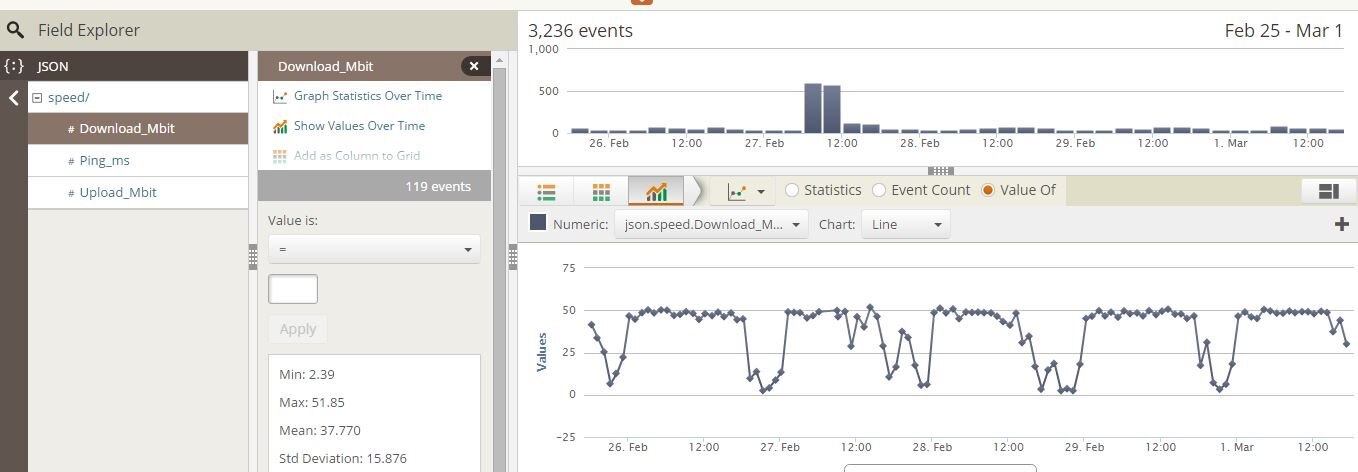

Hi all,
Background to problem:
I recently signed up to Virgin Media 200Mb broadband which kept dropping to around 5-8mb from 6pm onwards (sometimes lower). After a number of phone calls resulting in nothing but lost time with the virgin media team I came across a pretty neat guide, on how to use a raspberry pi as a broadband speed monitor using Loggly.
Loggly allows you to upload system log files and then interpret them as a nice graph. (with only minor tweaking)
Guide here; http://blog.scphillips.com/posts/2015/05/monitoring-broadband-speed-with-loggly/
As suspected virgin media have oversubscribed the line so at peak times I get around 5% of the quoted 200Mb speed image
The raspberry pi is plugged in via an ethernet cable directly into the router, but appears to max out at around 50Mb.
Still pretty cool and a nice use for the raspberry pi.
First post be kind

    If you use wireless USB, you can get up to 150 Mbits/s on 802-n
    Clem
