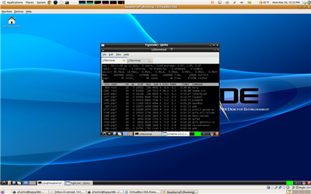

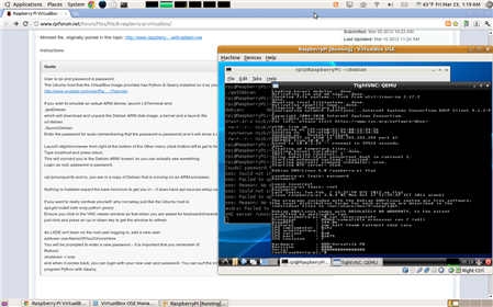

    So far I've downloaded the VirtualBox VM file from here:
    http://www.rpiforum.net/forum/files/file/8-raspberry-pi-virtualbox/
    and have run through the instruction on that page.  I have the debian install of Raspberry Pi running which is emulated with QEMU:

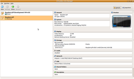

    When I first launched the VM, I was having horrible response time with high load along with swap increasing.  The VM from Russell Davis ran well so I modified the settings for this VM to match, including knocking the memory down from 1024MB to 768MB:

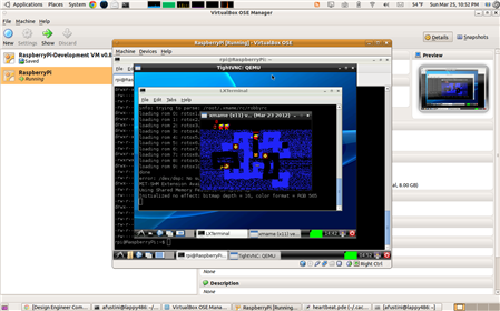

    fustini over 14 years ago in reply to fustini
    Alrighty!  xmame finished compiling over night and I finally got a chance to take it for a spin.  Here is a screenshot of playing the game robby (http://mamedev.org/roms/robby/):
    And here's a short video clip of the gameplay:

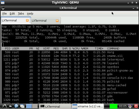

    e14 Contributor over 14 years ago in reply to fustini
    That emulator uses the same ammount of memory that the raspberry uses?
    Because as far as remember, LXDE alone costs around 256MB.
    Which modifications you have on this to make it use less memory?
  • fustini
    fustini over 14 years ago in reply to e14 Contributor
    Hi - that's a very good question.  I fired up the emulator again and ran top with xmame open.  It looks like it is all within the 256MB RAM.
    Here's sorted by resident memory size:
    And sorted by memory % utilization:
