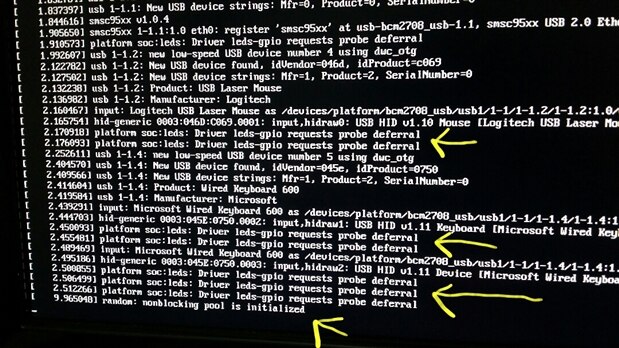

I've been trying to get the Raspberry Pi 3 B working with the Cirrus Logic Audio Card this weekend with no success. This Element 14 page for the card clearly says the RPi 3 B is supported so I would imagine someone actually made sure this was true. I've tried several times to follow the directions provided by Cirrus Logic in their Github repo.
Here's exactly what I did:
1. Set up an SD card with the latest Noobs.
2. Install Rasbian and log in.
3. Connect to my WiFi network.
4. Change the keyboard to English US.
5. Open the web browser to pull up my notes.
6. Carefully run the following commands in order which I've adapted from the wiki.
$ sudo apt-get update && sudo apt-get -y upgrade
$ sudo apt-get -y install bc
$ mkdir -p /tmp/AudioRepos/raspberrypi/tools
$ mkdir -p /tmp/AudioRepos/CirrusLogic/rpi-linux
$ git clone --depth 1 https://github.com/raspberrypi/tools /tmp/AudioRepos/raspberrypi/tools
$ git clone --depth 1 https://github.com/CirrusLogic/rpi-linux /tmp/AudioRepos/CirrusLogic/rpi-linux
$ make -C /tmp/AudioRepos/CirrusLogic/rpi-linux bcm2709_defconfig
$ make -C /tmp/AudioRepos/CirrusLogic/rpi-linux -j4
$ make -C /tmp/AudioRepos/CirrusLogic/rpi-linux -j4 modules
$ sudo make -C /tmp/AudioRepos/CirrusLogic/rpi-linux modules_install
$ /tmp/AudioRepos/raspberrypi/tools/mkimage/mkknlimg /tmp/AudioRepos/CirrusLogic/rpi-linux/arch/arm/boot/zImage /tmp/AudioRepos/raspberrypi/tools/mkimage/kernel7.img
$ sudo cp /tmp/AudioRepos/raspberrypi/tools/mkimage/kernel7.img /boot/kernel7.img
$ sudo cp /tmp/AudioRepos/CirrusLogic/rpi-linux/arch/arm/boot/dts/rpi-cirrus-wm5102-overlay.dtb /boot/overlays/
$ sudo bash -c "echo 'dtoverlay=rpi-cirrus-wm5102-overlay' > /boot/config.txt"
$ sudo bash -c "echo -e 'softdep arizona-spi pre: arizona-ldo1\nsoftdep spi-bcm2708 pre: fixed' > /etc/modprobe.d/raspi-blacklist.conf"
$ git clone --depth 1 https://github.com/CirrusLogic/wiki-content /tmp/AudioRepos/CirrusLogic/wiki-content
$ mkdir ~/AudioScripts
$ mv /tmp/AudioRepos/CirrusLogic/wiki-content/scripts/* ~/AudioScripts/
$ chmod +x ~/AudioScripts/*.sh
$ sudo shutdown -r now
Then on restart, the Pi hangs. There are several "Driver leds-gpio requests probe deferral" messages which might mean something. There is also "nonblocking pool is initialized":

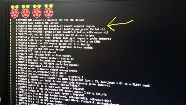

In addition, there is an error related to mmc_bcm2835:

Anyway, even though I know a thing or two about the command line, I'm not really a low-level guy. I don't compile kernels so I'm not sure how to diagnose this, or even what these errors mean. But I can guarantee you having the CL Audio Card with a RPi 3 B and following the steps above, anyone can replicate this issue.
Does anyone have first-hand knowledge that these two actually work together? Can anyone help me figure out what is wrong with my configuration?

    Good news!
    I was able to boot the Raspberry Pi 3 B and I got the sound card to play back some audio.
    I noticed a post from another discussion where user hiassoft linked to his own page with source code and compiled kernels. I downloaded and installed the pre-compiled kernel and followed the configuration instructions. On restart, and after running the appropriate script, I was able to get sound from a YouTube video with my headphones hooked up to the audio card.
    So it seems to work!
    Next step will be to try to compile the code myself and to reconcile the differences between the hiassoft's code and the out-dated Cirrus Logic repo.

    e14 Contributor over 10 years ago in reply to e14 Contributor
    Alright so the two versions aren't even close. It looks like Cirrus Logic has abandoned updating the software. Meanwhile, amazing work is being done here: Driver fixes and updates to kernel 3.18.16 and 4.0.5
