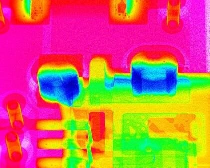

    e14 Contributor over 14 years ago in reply to rew
    All
    As a follow up to my previous post here is an X-Ray of the Micro USB.
    Sorry about the funky colour scheme but it hard to pick out the tabs from a lump of solder (lead free) around them (blue in blue).  You should be able to see that the tabs are present and will resist the lateral force applied.  They are not as tall as the thickness of the board as they are primarily used on very thin laminate (0.6mm) and we are at 1.4mm.  I should also mention that we are looking from the back through the PCB.  You can also just see below the tabs, the green area with yellow flecks; that is the two solder pads under the front of the connector, and they seem to be reasonably well soldered.  The voiding (yellow flecks) are normal some better than others.  The orange tubes to the left are vias in the PCB.
    I'm sure if we get any failures of this component I'll be the first to know, because you guys will tell me. image
    I think I'll go an chase some of these posts on power issues relating to duff cables and 'suspected' duff polyfuse parts.  Let you know what I find.
