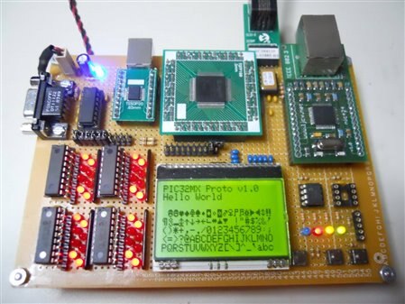

    I had a great experience using the Microchip GPIO extenders, they work really well, you can chose a part with I2C or SPI support, and on SPI mode
    you can even share the SPI bus with multiple GPIO extenders sharing also the CS signal for all of them.
    I've a pair of boards, one has a PIC32MX with four 8-bit GPIO extenders (shown in the picture) and the other one is an expansion to this one with
    another four 16 bit GPIO extenders. Highly recommendable part, requires a little bit of programming but the work really well.
    -J
