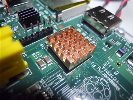

    These are the ones I ordered and have on my boards:
    For the S0C:
    http://www.ebay.com/itm/ws/eBayISAPI.dll?ViewItem&item=120820119736&ssPageName=ADME:L:OC:US:3160#ht_500wt_1180
    For the SMSC and Regulator:
    https://www.sparkfun.com/products/10746
    For the smaller ones from SparkFun I had to get some extra thermal adhesive tape since the one they sent with the heatsinks does not work very well.
    I also purchased this by didn't use them yet, the copper ones look nicer and arrived sooner:
    http://www.ebay.com/itm/ws/eBayISAPI.dll?ViewItem&item=280820745494&ssPageName=ADME:L:OC:US:3160#ht_2483wt_1397
    Since the R-Pi became now a marketing horse for some folks you will find people now selling specific kits for the R-Pi
    Ohh, here is a pic with the heatsinks in place ...
    -J

    Does anyone have any opinions on the effectiveness of thermal adhesive tape versus thermal bonding adhesive paste?
