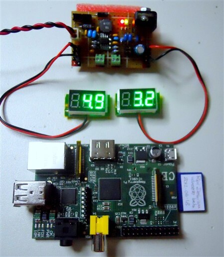

Just finished the power supply board I'm planning to use on a development gig for the Raspberry Pi. The board can take from 7-28VDC and uses a Texas Instruments switching SWIFT DC-DC converter to take it down to 5V (up to 2.0A) and a LM3940ISX-3.3/NOPBLM3940ISX-3.3/NOPB LDO Voltage Regulator for an extra 3.3VDC output.
No phone charger aquí ...
Next replace the polyfuses by 0 ohm resistors so I can hookup my landmower to the USB port if I wish, and start mounting everything with the solderless prototyping boards.
Fun, fun, fun ....
I'll post more pictures later and share schematics, etc.
-J

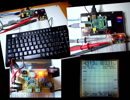

    Here is the whole Raspberry Pi prototyping gig ... Everything is mounted on the solderless prototyping board, power supply is on and feeding the 5V directly to the expansion header of the Raspberry Pi board. Right now the bench power supply is set on ~7.2VDC, about ~300mA. The test leads are currently connected to a Fluke ScopeMeter running a trend plot (lower right corner picture) monitoring the 5V supply and the R-Pin internal 3.3V LDO Voltage Regulator.
    Raspberry Pi is on and running the Debian Wheezy beta image. Ready for some prototyping wiring and coding of a couple of projects.
    P.S. I don't know if you noticed on the picture, but the LAN9512 has now a tiny black heatsink I got from SparkFun, I waiting for some bigger ones I ordered from China for the SoC.
    -J

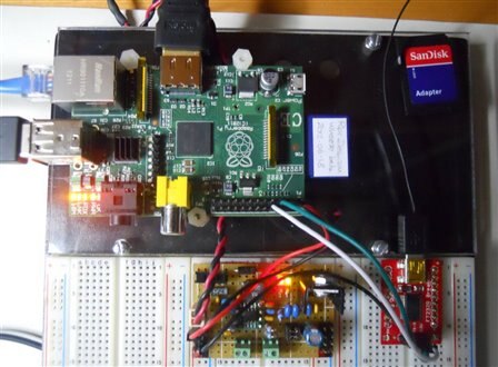

    FTDI232L breakout board (http://www.sparkfun.com/products/718) is in, right now I've the R-pi totally "headless", no keyboard, no monitor, just serial console via the FTDI chip to USB and virtual serial port on the PC running TeraTerm, works like a charm.
    I'll measure it better later but there is obvisouly a noticeable reduction in current draw without the keyboard and HDMI.
    -J
    e14 Contributor over 14 years ago in reply to jamodio
    I'd be interested in your findings.  With a ps/2 keyboard and mouse through a ps/2->usb adapter I saw maybe 10mA difference removing it. Removing HDMI didn't get any measurable difference.
