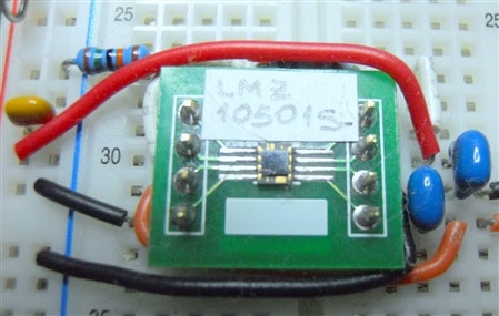

    What switching regulators are you looking at ?  TI has a very nice and vast line of them, particularly the SWIFT ones are highly efficient.
    I had very good results with this tiny one from TI (actually an original National part later acquired by TI) which switches from 5V to 3.3V and can handle up to 1A, it is QFN and has the inductor incorporated on the chip (soldering and rework has to be done carefully to avoid removing it)
    http://www.ti.com/product/lmz10501
    Here is a pic of one mounted on a SMT to DIP adapter for testing (not the best or recommended pcb layout, but it worked).

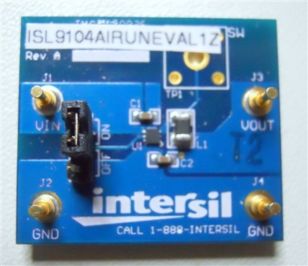

    One alternative I'm using on other designs is the ISL9104 from Intersil, it is high efficiency with low Iq running at 4.3MHz, so the inductor is just a small ferrite bead. Up to 500mA.
    http://www.intersil.com/en/products/power-management/switching-regulators/integrated-fet-regulators/ISL9104.html
    Here is a pic of a small evaluation board:

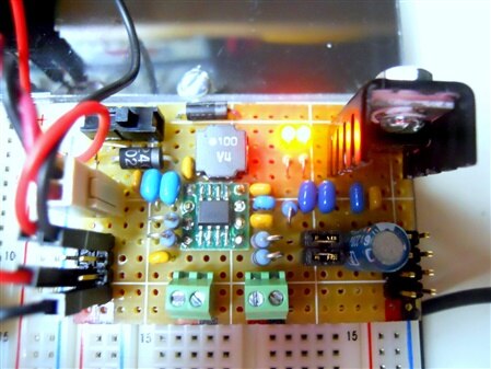

    Hi
    yes your spot on, it is the LMZ10501 that i am trying to use and i have now got one of them mounted on my boards.
    it is set for 3.3V ouput with the resisitors as per the PDF files but i am getting 3.27V so i guess that i have to change the values abit so i can get it a little higher.
    here is an analyze of my module (it is in microsoft xps format as i dont has a pdf writer installed)
    http://www.tooms.dk/Download/element14forum/raspi/LMZ10501-3.3V-V1.20120923.1652.xps
    as you can see it is first hitting 90% eff. at 100mA and seems to top with 93,9% at 260mA, but it is alot better then the LDO.
    Now i just need to build an 1.8V and 2.5V board and then do testing with the RPI board.
