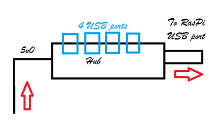

    By "fuses F1 and F2 gone", I'm actually referring to RasPi 2.0 which -- as far as we can tell without schematics -- directly connects RasPi 5V0 to the downstream USB VBUS pins.  You can get the same effect on RasPi 1.0 by shorting out F1 and F2.  One way to do this is with 0 Ohm resistors that are the same size as F1 and F2, as RasPi has done with some recent boards.  You can also short them out with pieces of wire, leaving F1 and F2 in place.  You can also short them out using a higher-current fuse in parallel, which has the advantage of leaving in some protection.
    If you remove F1 and F2 from a rev 1.0 RasPi, you won't get any connection between RasPi 5.0V and your hub's 5.0V, so you will need to provide separate external power for RasPi and your hub.
    Your "reboot in 1 second" behavior is well known.  What happens is that the SoC can get enough current to start the boot process, but when it gets under way and needs more than 140 mA, the voltage drop across F1 or F2 (depending on which USB port your hub is plugged into) gets too high and 5V0 drops too low to keep the SoC alive, so it reboots.
    So if you're adventurous and don't mind voiding your RasPi's warranty, shorting out F1 and/or F2 and powering RasPi through your hub's upstream connection will probably work.  After all, that's what's RasPi is allowing officially with the 0 Ohm resistor change.
    Also, this will only work with some hubs.  A hub is not supposed to send current upstream.  My hub has a diode to prevent this from happening.  However, there seem to be quite a few hubs out there that do source current upstream, so RasPi decided to fuggeddabouddit and short out F1+F2 rather than de-list a bunch of hubs and listen to complaints.

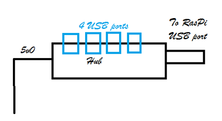

  • wallarug
    wallarug over 13 years ago in reply to johnbeetem
    This is what I mean:
    Is this what you are also talking about?
