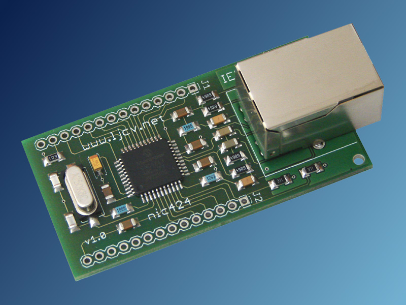

    Hmmm, that would be some interesting project to try, as far as I remember there are some Linux drivers for the Microchip standalone Ethernet controllers, obviously don't expect to power the thing from the regular 3V3 power supply.
    I used to produce this board based on the ENC424J600
    http://www.ljcv.net/nic424/nic424-v1.0-800px.jpg
    I'll put on my to-do list of things to try in my protoboard setup... Good idea selsinork
    -J
    What, no 1.8v version that I can power from the lan9512 ?  image
    Nice looking board..  I know it'll work - Chris Boot and Simon Arlott were using them along with sd-card on spi during their 3.5 kernel efforts.
