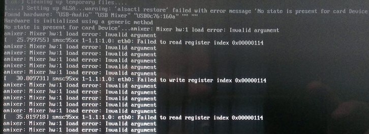

    I rtied that but no luck however having booted the RPi up again this morning I got these errors:
    Looks like the device driver is not loading - I should have tried rebooting before!
    I then rebooted again and I get a load of errors like:
    smsc95xx 1-1.1:1.0: eth0: kevent 4 may have been dropped
    hundreds of them!
    I have read on a few forums about common power issues with USB and I wonder if my current wiring (the RPi being powered from the lapdock) is causing issues.
    I'm going to try powering the RPi directly from my mobile charger, the lapdock via it's own charger and get out my powered hub out if necessary and see if that has any effect.
    Regards
    Spencer
