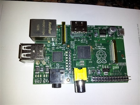

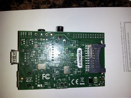

  • fustini
    fustini over 13 years ago in reply to fustini
    My Pi from MCM received on Friday had the 0 ohm resistors, too:
    Interestingly, I noticed that it also has D14 removed after seeing this thread: Re: another board revision: D14 gone
