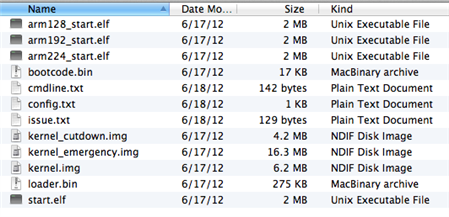

    also try to verify content of sd card in another pc
    in official image you can find file issue.txt
    in latest includes "Raspberry Pi reference 2012-10-28 (armhf)"
