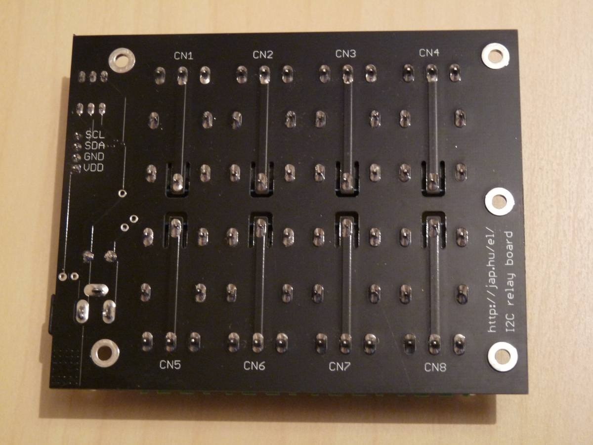

    jakabp over 9 years ago
    You can directly connect these relay boards to the Raspberry Pi without glue logic: https://www.tindie.com/products/jap/8-channel-relay-board-for-raspberry-pi-and-arduino/
    The I2C version is compatible with the Raspberry Pi's 3.3V logic and you can connect up to 8 boards to the same bus. The USB version is also suitable and code is provided to control multiple boards from the Raspberry Pi.
  • Robert Peter Oakes
    Robert Peter Oakes over 9 years ago in reply to jakabp
    Can you provide a view of the back of the board, I would like to see the clearances of the logic tracks from the mains tracks. I ask because your site claims use with 240V AC and 7odd amps. what would be nicer is a board layout view showing the tracks top and bottom so that the clearances can be seen.
    I am not saying your board is un-safe or safe, I don't have enough information to judge. But I don't see CE or UL certification, and more importantly I did not obviously notice warnings about using / handling MAINS and using trained people to implement that part of any assembly.
    So if you're confident of your design and board layouts, please share a close view. It will save a lot of grief from the Top Members as people have found in the past regarding MAINS Control based addons.

  • jakabp
    jakabp over 9 years ago in reply to Robert Peter Oakes
    Here is a quick shot of the bottom side.
    Thanks for the fast response. I like the fact you have had additional routing around the mains common of the relays to increase the creepage allowance, certainly looks like your meeting or exceeding code there which is great, looks like all the logic lines are on the top side, would I be correct to assume there running down the middle of the board , I can not make out how close they come to the contact pins of the relays with the available pictures.

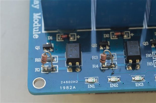

    mcb1 over 9 years ago
    You can drive the Opto-coupled boards with the 3v3 I/O of the RPi.
    In most cases they have a 1000ohm resistor and LED in series with the LED part of the opto-coupler.
    You simply add another 1k across the existing one, and they'll happily drive from the 3v3 RPi i/o pins.
    You'll need both 5v (for the relays) and 3v3 for the channel drive as these boards are active low (ie you make IN1 LOW to turn on the relay)
    With 10 relays the other suggestion takes much less i/o pins.
