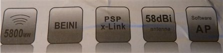

I seem to be unable to adjust the tx power above 20dbm.  I have tried: 'iwconfig wlan0 txpower 22' but this does not change the txpower.
I have also disabled the power-management.
The adapter claims that it can hit 5800mW of power which aquates to about 37dBm.
Does anyone know how I can get the txpower up? (I can put it down, just not up)

    1.  Is it telling me the truth that you can put 1.1A@ 5 volts into a Kinamax TS-9900 without blowing it up?
         NOTES:
         -  It 'claims' to have a txpower of 5800mW with a 58dBi Antenna.
         Transmission Power: 5800mW @ 38dBm ± 1dBm - http://forum.lowyat.net/topic/2414082/all
    2.  What are the signs that it is not copeing with the 1.1A of power?  Fire?  Smoke?  Burning Electronics Smell?  Heat?

    These are very ambitious figures.
    I doubt its posible to get 58dBi out of that antenna design.
    I have a 32km wireless link, that has a 24dBi grid pack antenna on the roof, and the TX power is 29dBm, and we are limited to 2MBps, although it probably will do more.
    With 2.4GHz, interference and close objects can cause the biggest loss of performance, despite the power settings.

    shabaz over 13 years ago in reply to wallarug
    I'm pretty sure (from the numbers mentioned) the card has 20dBm power output, and the antenna is 17dBi. This would be how they derived their so-called "equivalent" of 5800mW (which is not true). It means if your antenna radiated outward equally, then yes you'd need 5800mW for the same range, but actually on a lower transmit power the antenna is directional and has a 17dBi gain for the same range but no longer in all directions.
    I'm not familiar with many antenna topologies, but from a google search it does look like there is a topology that offers 17dBi.

    wallarug over 13 years ago in reply to shabaz
    Then why advertise it has 5800mW 58dBi ???
    Why I first looked at the numbers, they don't add up.
    Here's another catch though...
    It claims range upto 5km.
    If it is USB powered, then we know it is extremely unlikely that it really has 5800mW power output.
    Given that, if you work backward, there is a 'possibility' that they are implying 'range equivalent to 5800mW but just in one direction'.
    With that possibility, this means a 20dBm power output followed by a 17dBi antenna. 17dBi antennas do exist (not that I'm any expert in
    antenna technology) for WiFi from a google search, so this seemed to add slightly more weight to the possibility. I seem to remember
    while back you already confirmed that the device was set to 20dBm in software.
    I could be (very likely) totally wrong, but I imagine you'd need to contact the manufacturer to be really sure.
    The fact that they state the digits '58' in both 5800mW and 58dBi sounds like a typo - maybe they meant 38dBi (which is still not the
    right way to state things but maybe they were implying a 18dBi antenna which is possibly a rounding up of 17dBi. I'm just playing
    with their numbers, which is all anyone can do without further knowledge. It's all speculation, so really you'd need to check with
    the manufacturer. Any of their figures could be a typo, leading any conclusion anyone makes to be wrong.
    Regarding distance, anything could throw off the real world distances (antenna construction, loss in coax and connector, reflections.
    I know that playing with the digits seems like one possiblity of error.  But when I looked at about 10 or so sites, it seemed all of them have it listed as '5800mW 58dBm', which in itself is a contradiction.
    I don't know how to contact the manufacturer as they seem to be a ghost company.  Kinamax does not seem to exist unless you want to buy their product from ebay or other store.
    The Box I have Specifically states:
    5800mW Power and 58dBi antenna
    I just looked at the box:  there is a link to a manufacture:  www.antmax.tw
    I will look into this site.

    M0DCD over 13 years ago in reply to wallarug
    I'd take these specs with more than a pinch of salt! First of all they are somewhat optimistic in terms of range, you can get a decent link over about 5km "line of sight", that is with no obstructions across clear space. Start to add buildings or any objects in the path and you won't get that. That's on a good day, if it rains, forget it! Possibly in space maybe.
    There is of course the matter of licencing of course, these devices are meant to be licence exempt, but there are limits to both output power and ERP.
    Thought we have had our hands on some high powered kit, that is 1W output into a 16dB gain antenna it's been covered by the organisation who's been wanting the link, though here in the UK we've added this to our group licence NoV for this.
    5800mW output power is unresonable, there's not a way you'd get that sort of power out of anything off the shelf. As for receiver sensitivity it's not down to background noise levels really, -70dBm would be more realistic. However, there is the point that some access points are set up to ignore weak signals anyway, so your efforts at DX may be in vane.
    http://www.element14.com/community/groups/amateur-radio-group/blog/2010/04/25/extreme-wifi
    mcb1 over 13 years ago in reply to M0DCD
    Cian
    I think you should be able to work out that the manufacturer is not using english as a first language.
    The descriptions are gramatically incorrect for a start.
    Your calculations are based on solid reasoning , but the fact still remains that it has to be two way, so even if you were pumping 10kw out, the link wouldn't work.

    regarding the USB.
    5v at 500mA gives 2.5 watts.
    I note a 500mW (27dBm) devices with 5dBi antenna is available as a USB device.
    I think as Shabaz has indicated, that the 5800mW is the eirp (Effective Isotropic Radiated Power) ie the equivalent power required if you had a dipole...
    I seem to recall some similar claims about audio power. The marketing department invented this peak power measurement, which of course is a mathmatically anomoly.
    It made the speakers and amplifiers look great though.

         Loss (L)  = 1 dBm
         Gain (G) = 21 dBi
    Then you end up with 58dBm total power.
    Now what does the 5800mW (37.635dBm) relate to?
    mcb1 over 13 years ago in reply to wallarug
    Cain
    Common myth.
    Power is consumed or used, not put in.
    Bit like a loaded trailer on a car, it requires x amount of power to move it.
    if you stick a 1000Hp car on the front the trailer still requires the same power to move it.
    However they derived the figures it doesn't really matter.
    Is the device working for you.?
