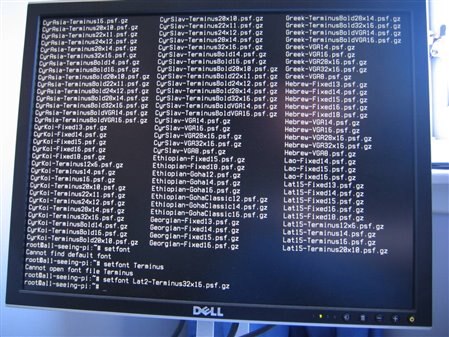

I find the Pi's HD-text size too small at 1080 resolution on  a monitor and Atrix.   If I set the resolution to 720 in config.txt, it;s better, but that
lowers the graphical resolution too much.
Is there any possibility of  changing screen resolution on the fly ? The ideal would be to boot into 720, then change resolution to 1080 inside startx
(and revert on exit...)
It is possible to select text-size in the lxde-terminal, but that's no help at login.

    You might have a look at this as a starting point http://alexandre.deverteuil.net/consolefonts/consolefonts.html the screenshots of the fonts might help you pick one.
    Most of them look terribly similar to me, but perhaps one of the 12x22 fonts like sun12x22, iso01-12x22, iso02-12x22 may be better.
    You can also use the 'setfont' command from a text console (i.e. before you do startx) to try out the different ones temporarily. Some examples of how to use setfont are here https://wiki.archlinux.org/index.php/Fonts#Console_fonts
    Using a recent version of Raspbian, I put the following into /etc/default/console-setup
    # CONFIGURATION FILE FOR SETUPCON
    # Consult the console-setup(5) manual page.
    ACTIVE_CONSOLES="/dev/tty[1-6]"
    CHARMAP="UTF-8"
    CODESET="guess"
    FONTFACE="Terminus"
    FONTSIZE="16x32"
    VIDEOMODE=
    # The following is an example how to use a braille font
    # FONT='lat9w-08.psf.gz brl-8x8.psf'
    On reboot the initial screen has the usual tiny font, but partway through there's a pause and then it flips to the much bigger font.
    In theory this should work for you, but check for typos in the highlighted changes above.
    Before:
    After:
    The Terminus font looks ok to me, and I'm assuming this big version is what you're after..

    Many thanks, I've managed it. My problem was  16X32 instead of 16x32  !!   Now it's simply ENORMOUS !!
