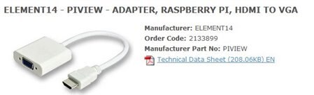

my monitor has only VGA.Can I use DVI-VGA adapter to connect HDMI-DVI cable to monitor?

    I bought DVI-VGA adapter but the screen is black.
    I dont know what to do?

    Raspberry Pi only has digital HDMI signals.  They are compatible with a DVI-D monitor, but not VGA.  You need a converter box to convert the digital signals to VGA analog signals.  There's a lot of information at the RasPi Hardware Wiki here and here.
    DVI as produced by most PC video cards is DVI-I, which has pins for bit-serial digital signals (DVI-D) and other pins for VGA analog (DVI-A).  Since a PC video card has both, you just need a cable to attach it to a DVI-D monitor or a VGA monitor.  But this doesn't work with RasPi, since it only has digital on the HDMI connector.

    There used to be a HDMI to VGA adapter showing in the Pi Accessories.
    I can't seem to find it now...

    mcb1 over 13 years ago in reply to e14 Contributor
    I knew I saw one.
    The part number should be the same at most e14 outlets, and is listed at NZ $32.48 inc tax.

    Mark, thank very much :-)
    Today I was visiting my brother in Belgrade (Serbia) and he gave me his old monitor
    which of course had only VGA but also some mysterious port.
    Later I found out that it is a BNC.
    So now I have to buy RCA-to-BNC adapter (very very cheap) to connect my Pi with "video" cable... image
    I know that screen quality is poor but I'll try that for now.
    Mark, I found your adapter at Farnell and I will try to buy it.
