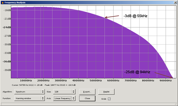

I'm interested in investigating this board for creating ultrasonic recordings of animal noises. Some of these animals generate calls that are of a high frequency. I was wondering if anyone knows if ill be able to record audio up to 192kHz?
Thanks
    The maximum theoretical audio frequency is half the sampling  frequency. Nyquist–Shannon sampling theorem - Wikipedia, the free encyclopedia
    Thus, if the hardware were perfect, the max audio frequency you could record would be 96 kHz.
    But, as we all know, hardware is never perfect.
    I did a quick test by feeding white noise at a 192 kHz sample rate into the Line In of the Wolfson card and recorded it.
    Using Audacity's "Plot Spectrum" I got a chart showing the audio frequency response of what was recorded:

    I'm interest in recording bats which emit calls from around 12-160 kHz. If I could record calls up to 96kHz I would be happy. Do you have any experience using different ultra sonic mics with the Wolfson card.
    e14 Contributor over 12 years ago in reply to e14 Contributor
    Alas, I have no experience with such microphones. My interest in high-frequency audio is in analyzing the output from FM stereo transmitters. I'm happy if I can record up to 77 kHz.
    The card starts to struggle above 94 kHz, the sensitivity curve wobbles up and down quite bit up there. Anyway, up to 94 kHz should be doable if the rest of your gear is up to it. If you record at 24 bit depth, you should be able to compensate in software for the reduced sensitivity at the higher frequencies.

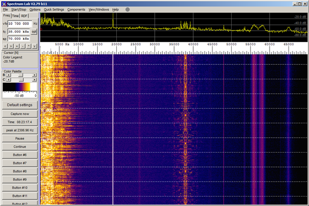

    I am looking to record or at least transmit over Jack an MPX signal from an FM transmitter.  My application will be the analysis of RDS signals living at 56kHz.
    Have you had any success in doing this with a Pi?
    e14 Contributor over 12 years ago in reply to aaronhorn
    Hi Aaron!
    This is from a WAV file I recorded on the Pi. The curve leans a bit to the right, but all in all it works better than I anticipated.
    I haven't tried to push 192 kHz audio through the network. I have done 48kHz between two Pis with Jack, though.

    Ragnar, that looks really good.  My main concern was that there might some issue with a LPF being fitted or indeed the -3dB point being far to low to capture useful data at 57kHz.
    I'm kind of interested as to what the peak around 65kHz is though?  Is it some kind of SCA carrier?
    That 65 kHz peak is why I'm looking at that transmitter in the first place. It shouldn't be there.image
    It has other troubles too...
    Ragnar
