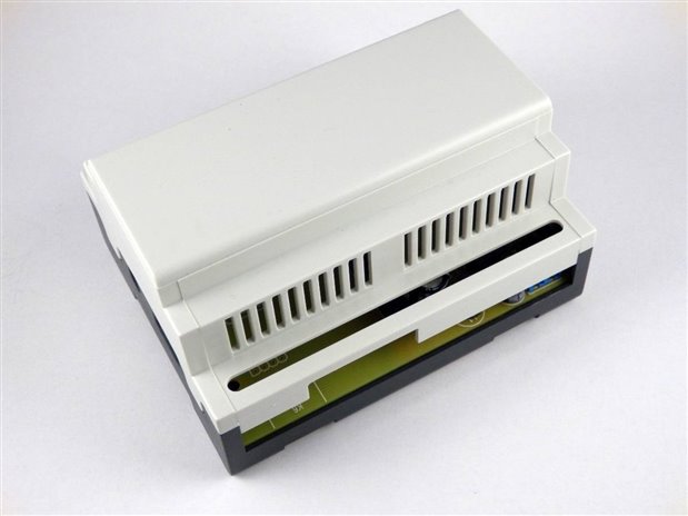

Hi,
here some pictures of a new project from me. It's a prototyping plate with fitting DIN rail enclosure for the Raspberry Pi. Check this Link for more information

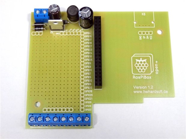

    here is a short update about the RasPiBox enclosure. Since some days we are offering a reworked version 1.2 with some modifications for the Pi3 and PiZero>:
    - stronger 5V DC voltage regulator with 1.7A output current
    - full THT design, makes soldering easier for beginners
    - wider sd card slot for the PiZero
    - optional USB-A socket for the Pi Zero

    Is that the actual supply circuit in the photographs? I'm guessing it is a switching regulator of course.
    Do you have a schematic for this full THT design?
  • hwhardsoft
    hwhardsoft over 10 years ago in reply to shabaz
    pls check this document for the circuit diagram:
    http://www.modmypi.com/download/Raspibox-assembly-RC.pdf

    It sounds a really great project. I like very much the solution. There is only a detail that sounds a bit strange to me. In the video you show a Raspberry PI A, that was slower than all the next models. Thinking to put a PI3, that is incredibly faster, are you sure that the reverse position mounting with the cooling holes make air circulating internally to the bottom of the PI board are reliable in a long or continuous usage? The processor in this enclosure result as the most closed part and the cooling ventilation does not include a fan, according with your images. Do you think it maybe the worth?

    Just a last not. I took a look to the (very well) documented circuit and assembly instructions. We should take in account that also the voltage regulator needs a sufficient dissipation surface and/or a forced ventilation. My worry is just that this very nice block will become too hot in few time.

    we sold hundreds of this enclosure sets for the PI2 before and I never heard about such problems by our customers. Between the pcb and the Pi CPU is enough space for an air flow - and if you want a heat sink also. Please note: Usually the enclosure is mounted vertically in a control cabinet!
    About the voltage regulator: Same as above. It's a very good tested design in several kits - for example in our mini arcade kits. For 24V input voltage and 2A output voltage it works without any heat sink. It's possible to mount a heat sink, because the regulator is placed to a position in the enclosure with enough height for vertical heat sink...
