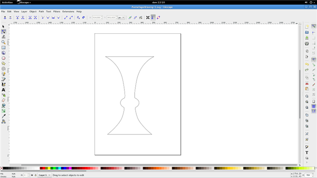

Right sorry if this sounds a bit daft (I am a compleat novice at this computer, software & engineering thing) I am a professional woodturner and I stumbled Across the raspberry pi by accident and was wondering if it was capable of doing the following
i want to design my woodturning projects on the computer but find CAD 3D design completely mind boggling so i am looking to use something like this Creative Woodturner - Woodturning Design Software - See a stunning 3D view of your woodturning design its a program for windows that's used to design (via nodes and a 2D view) objects made on a lathe with a 3D CAD output it would be really helpful just to know if it's possible on a raspberry pi

    Raspberry Pi is not that good for 3D rendering even while the GPU is not that bad, it's quite short on memory for this kind of task.
    I have a gantry CNC router and use to mechanize aluminium on it. It's not the same as a lathe - I would love to have one - but the tools at hand are quite close.
    The program you show does what is called 2 1/2 CAD design. You get a 2D CAD design, and extrude a height to make a 3D piece.
    Usually this is done to create a tool path to let a CNC enabled machine - router, mill or lathe - to read that paths and make the cuts, pockets and shapes designed by that CAD.
    If you want to know the tools I use for that - in my case I use to just cut few mm to few cm height pieces - for the 2D design I use LibreCAD, or Qcad - they have the same heritage.
    It's a 2D CAD where you draw the circles, pockets, contours and lines in 2D that define your design Home of LibreCAD, 2D-CAD
    In some cases - where the cuts involve text - I even use inkscape, that's an really easy to use SVG draw program-
    After that I use PyCAM. PyCAM is a python program that lets you load your 2D design and extrude it to 3D to let you make a 3D part. It also calculates the toolpaths for milling it, but I don't think it would work on a lathe. PyCAM - Toolpath Generation for 3-Axis CNC machining
    PyCAM can export to STL that's a very common 3D format. You can render it on Blender or any other 3D program.
    Sometimes I also load those 2D designs on OpenSCAD. OpenSCAD let you import any DXF 2D CAD file and mathematically extrude, transform, change color, move, join, split the part or do whatever you need with it.
    You can also use it directly, without importing the 2D CAD OpenSCAD - The Programmers Solid 3D CAD Modeller

    All those programs, LibreCAD, Inkscape, PyCAM, PyCAD, OpenSCAD and even Blender could be made to work on the Raspberry but I don't recommend it at all.
    Most of them can run on Windows as well. All of them are free.
    You want a quick and good PC to make 3D design, raspberry it's not what you really need.
    My recommendation is to take some time to learn a bit of 3D and 2D - start with the former - design. It have a quite step learning curve, but the rewards are huge.

    Craig,
    If your interest is only in wood turning, you do not need 3D software.
    It would be nice, but it is not needed. Because all the parts that you make are created
    by rotation around a fixed axle, you only need to create a cross-section of the piece you need,
    and that is only 2D.

    Thanks to bring this up here. I have been fiddling with the way the program you posted do things and I've found a very easy way to create woodturning - or any lathe machined piece - with inkscape and OpenSCAD that fits quite well in my workflow.
    You just need in inkscape to clone one line and mirror it, so any edit you do in the first line, is done in its mirror.
    That way the two 2D profiles would be a slice of the part.
    https://dl.dropboxusercontent.com/u/88765973/inkscape_woodturn.webm (you need a webm player to watch this video, such as google chrome, opera, firefox browsers or explorer with WebM MF components http://www.webmproject.org/ie/ ).
    To finally make a slice, I close the paths just drawing a line between the top ends and bottom ends, and combine them using inkscape tools ( Combine Path and Join Node).
    Now I have to export this 2D path to DXF to be imported by other tools. The most compatible way is just to divide the path in as many small lines as possible, because basic shapes are easily recognized among different tools.
    For this just use two Inkscape tools Extensions > Modify Paths > Add Nodes and after selecting all nodes the toolbar button "Make selected segments lines".

    After that I can just export it as DXF.
    Once we have that slice the only thing we have to do is to center it in one axis, extrude it a bit so it becomes a 3D part and copy the slice rotating it 360 times, one time for the circumference degrees. Of course we have to move it one degree more in each step to complete 0 to 360 degrees.
    This translated to OpenSCAD language would be, as seen on the video below:
    width = 531;
    for( i = [0:360] ){
         rotate(a=[0,i,0]){
              translate([-width/2,0,0])
                   linear_extrude(height=4)
                        import("file.dxf");
    The code on OpenSCAD to do it would be always the same just editing the width of the piece and changing the file name.
    In the video and the picture below I took the width of the bottom part, and the top was widder, so to center the piece I used a different translation. In this case -width/3.
    But is much easier to just use the part width so it will always be -width/2.
    https://dl.dropboxusercontent.com/u/88765973/openscad_woodturn.webm (you need a webm player to watch this video, such as google chrome, opera, firefox browsers or explorer with WebM MF components http://www.webmproject.org/ie/ ).
    After that the resulting STL can be loaded in a 3D program such as Blender or SolidWorks, or converted to gcode to make the part in a CNC lathe.
