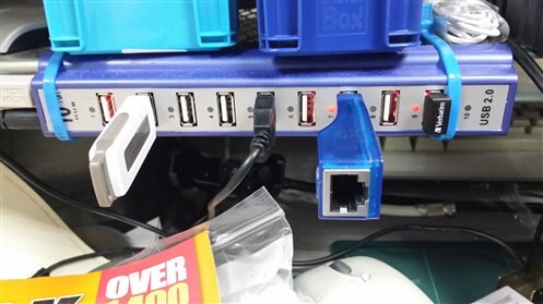

    Sorry to say but the performance is going to suck a bit either via  SPI or  USB, either way  you are going to end up sharing buses.
    Most SPI Ethernet chips already have drivers but you may have to compile them for the RPI  ( Probably still too much hassle!!!)
    A novel approach is to maybe use VLANs and a couple of virtual network interfaces on the PI but this requires an infrastructure that supports VLAN tagging etc.
    Probably the most obvious is something like the picture below where you get a cheap EBAY USB hub that's powered and bung some cheap USB-Ethernet adapters on it. This one has a DM9601 chipset and I'm sure I've had it on the PI and should work OK  if not a quick driver download will sort you out  ...Take the easy way out ....Good luck!
